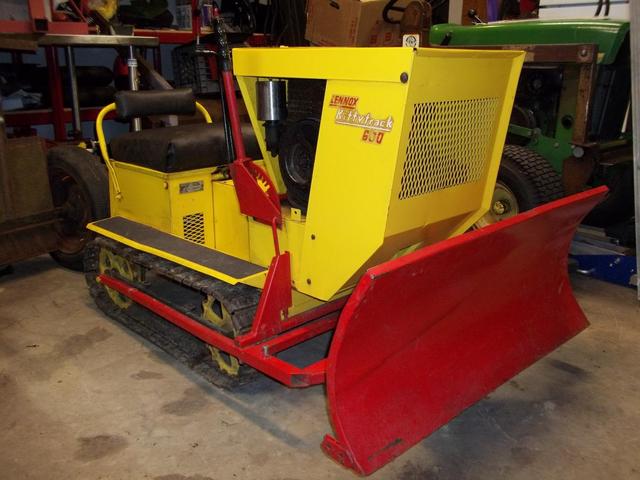

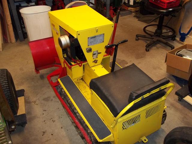

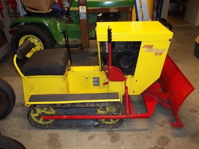

fireman 1,022 #4 Posted February 8, 2015 If your interested I can save you a lot of time and effort and sell you my mini dozer. It's a Lennon Kittytrack 600. Really rare. Needs a little work but it's all there and complete. I have the complete manual with parts break down. It's not cheap but would save you a ton of time and work. 2 Share this post Link to post Share on other sites
312Hydro 474 #5 Posted February 8, 2015 Fireman, Have you done a separate post on your dozer? That's an interesting machine. Share this post Link to post Share on other sites
