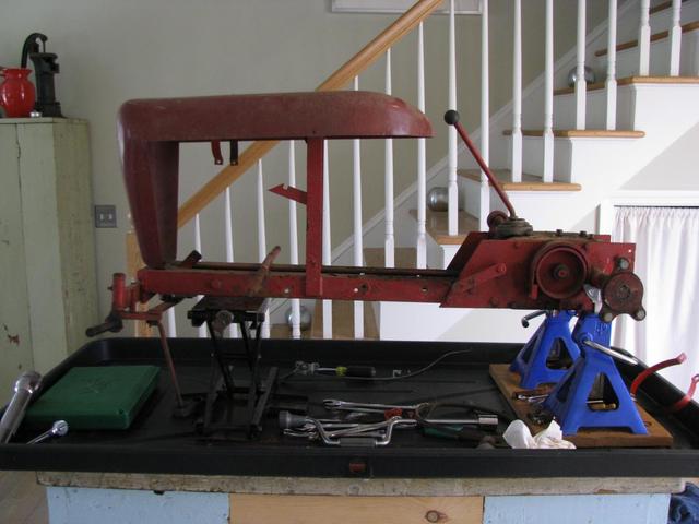

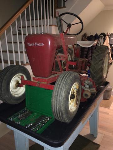

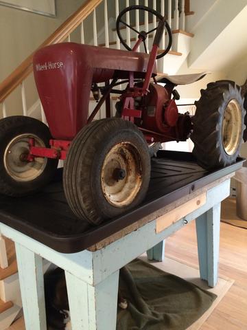

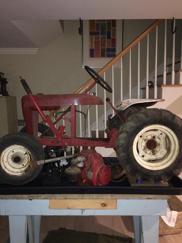

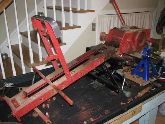

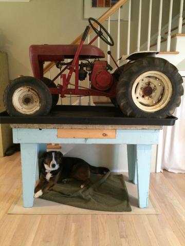

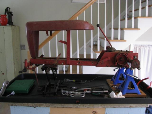

motor12 367 #26 Posted April 7, 2015 Is that the table the dog lives under..i think I see his blanket. 1 Share this post Link to post Share on other sites

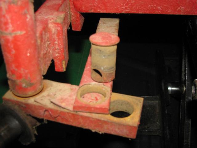

SMITTY 23 #27 Posted April 7, 2015 Your going to need some new clevis pins for the steering 22.00 shipped let me know. Smitty Share this post Link to post Share on other sites
mels 174 #28 Posted April 7, 2015 Yessir, one of my old Army blankets I brought Home from Korea in '85. Will let you know about the pins, Smitty. I've got a bunch of parts stuff around here from years of hit & miss engine and antique tractor hobby but finding it is a different story... Lol Share this post Link to post Share on other sites

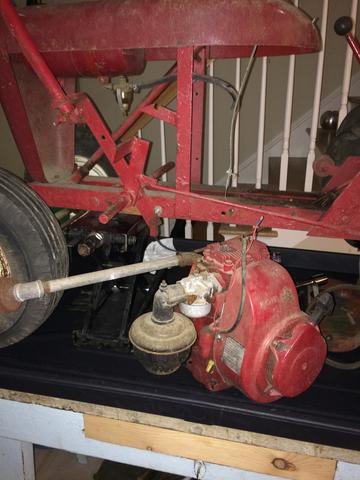

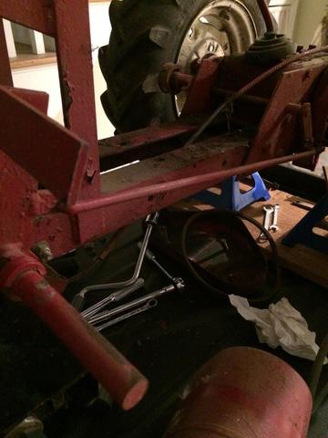

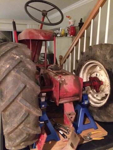

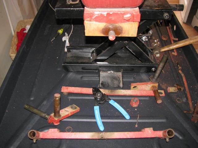

mels 174 #29 Posted April 7, 2015 30 x 60 condensate pan fits pretty good! Got it up off the floor this afternoon, Suppertime comin' then head off to Lodge for a meeting. Will give her a quick look over later this evening. Trying to figure out where I can take everything to be sandblasted, one more cabinet I just never had room for... Enjoy the new pics 3 Share this post Link to post Share on other sites

motor12 367 #31 Posted April 8, 2015 Great pictures, I also used a large drip pan when I disassembled my RJ, it kinda keeps the greasy stuff in one easy to clean spot. 1 Share this post Link to post Share on other sites

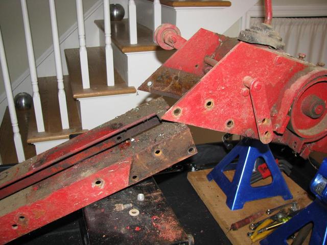

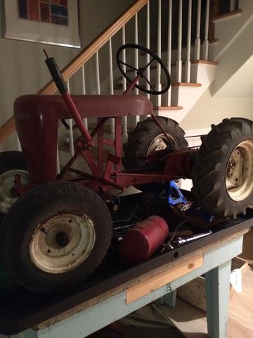

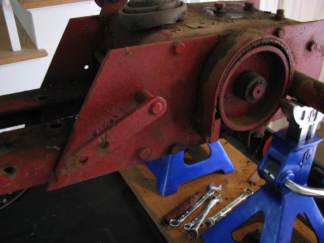

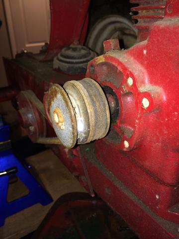

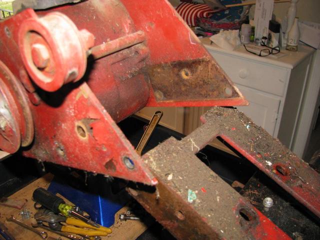

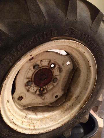

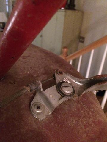

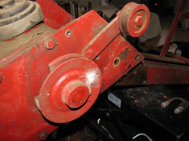

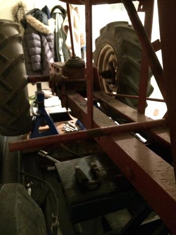

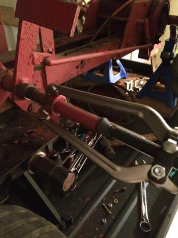

mels 174 #32 Posted April 9, 2015 Steve thanks for the lead, talked to sandblast Joe yesterday, will be seeing him soon. Will be taking to the paint guy today, try to coordinate everything so it all comes together as seamlessly as possible... That said, picked up an OEM Kohler carb kit and points from my long time friends at Newtown Power Equipment yesterday, got the old girl up off her hoops once I got Home and started the dissassembly process. Took a few pics along the way, enjoy. 1 Share this post Link to post Share on other sites
motor12 367 #37 Posted April 9, 2015 I look at every RJ58 picture I can find as I work thru my RJ project, (close to completion) and so far I have not seen two alike. There is always something assembled in a different order or just different parts all together. Looks like you have an array of quality tools at the ready so fighting rusted parts should be no problem. The only problem I had with stubborn rust was a wheel hub and it took days of PB blaster and a puller to get it off without any damage. Looks good. 1 Share this post Link to post Share on other sites

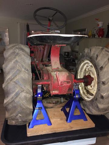

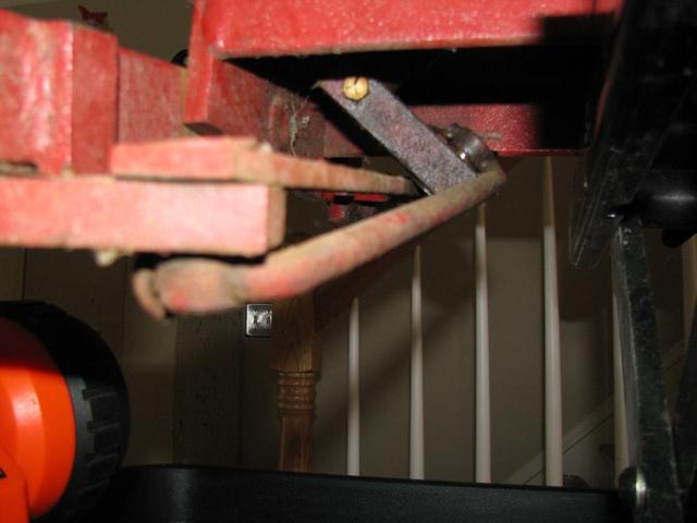

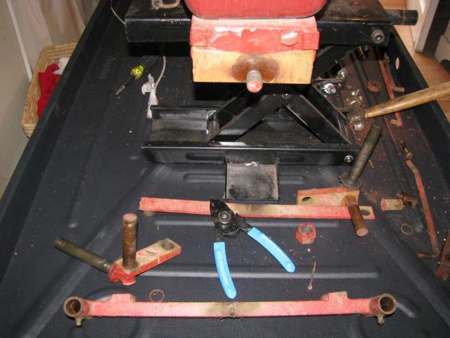

mels 174 #43 Posted April 10, 2015 Not at all, 'Motor, thanks for the testimonial it's good to hear, I'll order up a set when I get back to my computer tomorrow! Lol 'Bob, I guess if our garage were clear my beautiful Wife would have both this project AND me out there instead of in her clean white nest... Lol This was supposed to be something we chipped-away at while I recovered from surgery next week, guess I blew that plan huh? Took a few more pics this afternoon before we split for Supper, will post them up from the computer when I get back to work in the morning. Share this post Link to post Share on other sites

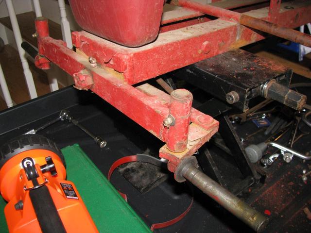

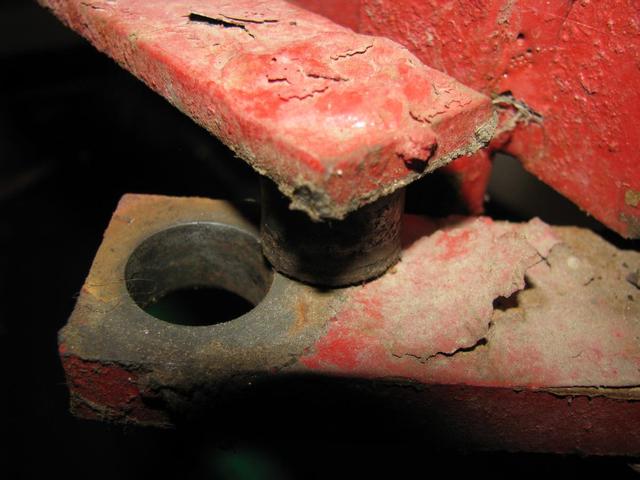

mels 174 #47 Posted April 10, 2015 (edited) So that's it for yesterday afternoon. Still need to decide what to do about the transmission, I know I should replace the seals at least while I have her stripped down this far and that input pulley has a broken sheave so maybe I'll replace it with an adjustable sheave pulley. Not too keen on splittling the transmission apart to look over the gearset and check out the mess in there, maybe someone can link me to a RJ tranny rebuild thread. I have a solvent tank parts washer out in the garage, maybe I'll uncover that this weekend along with some bench space and get into it. Pretty sure even Wifey would draw the line at the wonderful aroma of 30+ year old gear oil inside her house... Any supplier here for those seals? If not, Ernie at Sam Dallas here in town is right up the road and has always been able to match up what I've needed. http://www.samueldallas.com/ Edited April 10, 2015 by mels 1 Share this post Link to post Share on other sites
motor12 367 #48 Posted April 10, 2015 Mels one of the members on Red Square (Jake Kuhn) has the trans gaskets and he can help you on the seals and bearings. He usually has the gaskets on e-bay. I have used a couple of his gaskets and they work great, they are the correct thickness. 1 Share this post Link to post Share on other sites
Racinbob 12,890 #49 Posted April 10, 2015 Go to the reference section here under transmission instructional threads and videos and you will find all sorts of good stuff there. Stevasaurus has some great videos posted there. Don't be intimidated about opening up the transmission. Obviously you know your way around mechanical thingys so you won't have a problem. They are really quite simple. Download the repair manual in the manual section. I second motor12's comment on Jake. and there's also a cross reference for the bearings and seals here. 1 Share this post Link to post Share on other sites
