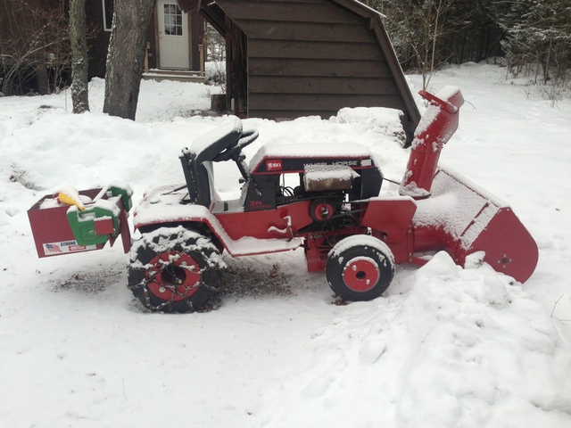

Ed Kennell 47,818 #7 Posted February 5, 2015 Luv my home made foot control on my 520H for snow blowing. It leaves the right hand available to steer and the left hand on the lift. The hand forward/reverse hand control is also still available for fine control when backing into a tight space. 4 Share this post Link to post Share on other sites

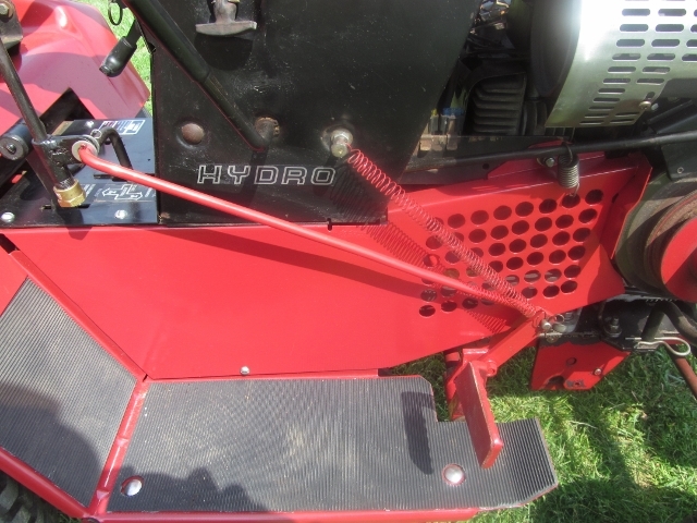

stevebo-(Moderator) 8,742 #8 Posted February 5, 2015 Ed- Love the engineering on that set up. Looks very basic and woks well I am sure. You may want to look at a centering spring like I have on my Terramite. It will return the foot pedal back to neutral. Share this post Link to post Share on other sites
Ed Kennell 47,818 #9 Posted February 5, 2015 Thanks Steve, I actually designed it with the goal of having complete full forward to full reverse control in one foot pedal. I did keep the thought of a notched plate and spring to auto return to neutral if the control was not good, but that would have required a second reverse pedal or a toe / heel type control pedal. I have replaced the coil spring with a pneumatic cylinder that effectively dampens and slows the speed of the motion control pedal. The new motion control pedal will go to reverse if you remove all pressure, and many will say this is unsafe, but the original left brake pedal is still fully functional and returns the motion control to neutral as the brake is applied. Share this post Link to post Share on other sites
stevebo-(Moderator) 8,742 #10 Posted February 5, 2015 Ed, I do not have a pic of the spring I am talking about however my buddy has used it on various machines and it works perfect !! The Terramite has the same set up too. Basically there are two posts welded a few inches apart and the spring goes in between the posts. When you push pedal forward pressure is applied to the spring and when you let off the pedal the spring pushes back against the pedal to return to center or neutral. Same in reverse. Share this post Link to post Share on other sites
Ed Kennell 47,818 #11 Posted February 5, 2015 (edited) Would like to see a pic or sketch of this sometime Steve. I am having trouble understanding how a auto neutral system works w/o two pedals or a toe/heel rocker type pedal. BTW, building the 520 for snow blowing, I did consider adding a foot control to the hydro lift to free up the left hand for steering. I may still do that at some point to free a hand for chute control. Edited February 5, 2015 by ekennell Share this post Link to post Share on other sites
