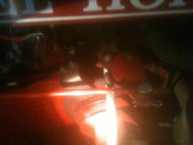

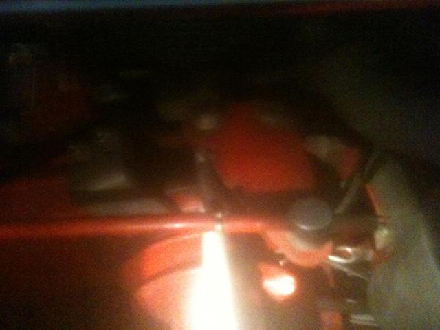

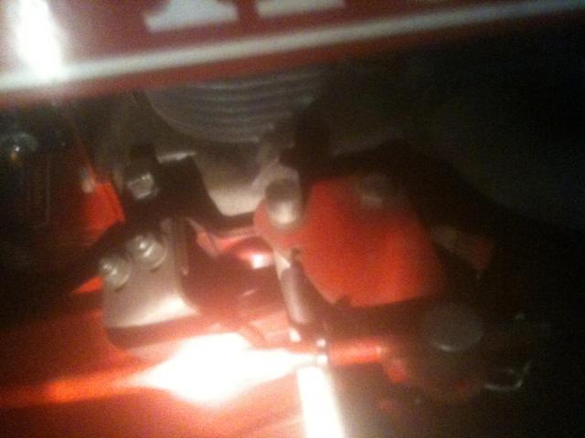

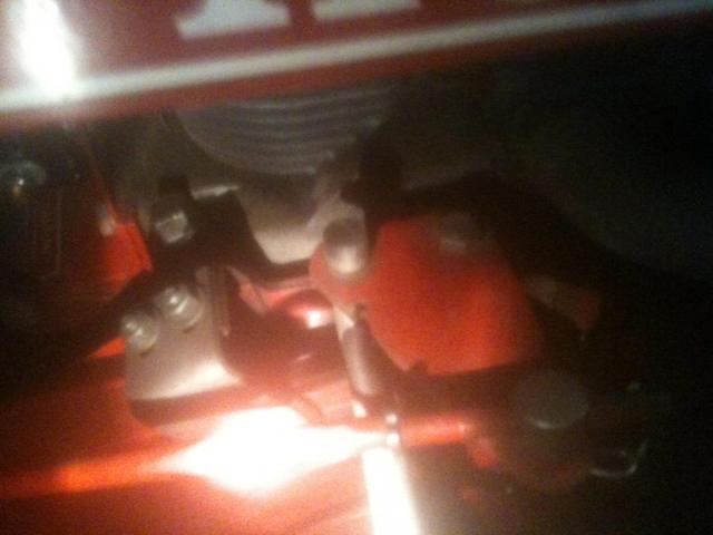

Lane Ranger 12,161 #2 Posted February 3, 2015 (edited) Adam: This may be hard to see but I took some photos of the small spring that rides on the engagement lever to operate the PTO on my 1975 Wheel Horse B-80. I think this will be similar on your 312-8 PTO. My 1993 314-8 does not have this spring on it as the design was changed. Also if I remember correctly a spring use to be inside the PTO bell housing and rides in the center of the bell housing. Partstree.com is what I use to find parts for the particular tractor that I am working on. Edited February 3, 2015 by Lane Ranger Share this post Link to post Share on other sites
TT-(Moderator) 1,185 #3 Posted February 3, 2015 There's a cotter pin through the clutch rod - back inside the hoodstand. One end of the spring hooks in the loop of the cotter pin and the other end fastens to the corner of the hoodstand. 1 Share this post Link to post Share on other sites
