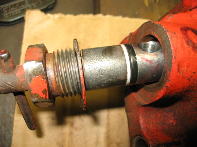

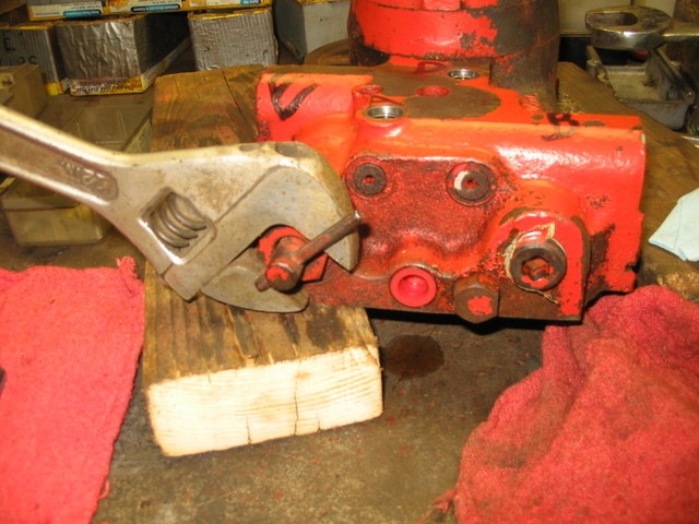

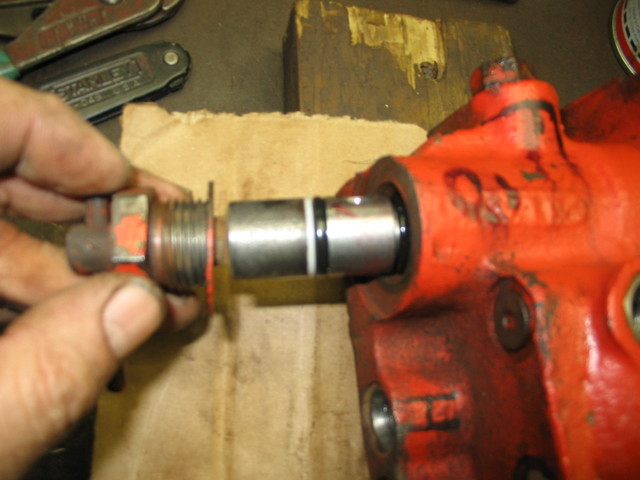

daveoman1966 3,884 #5 Posted February 3, 2015 If the tow valve is stuck, use a crescent wrench to back off (out) the top nut several turns. The whole valve comes out, then cleaned it up refit it. 2 Share this post Link to post Share on other sites
