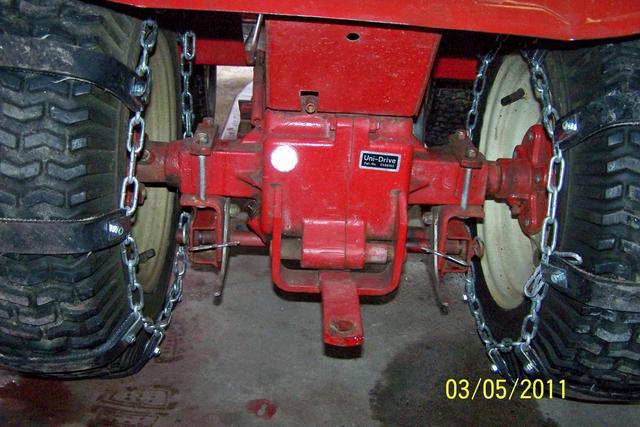

For the second time I have tried to plow snow with my 857 and not able to finish the job.  The first time I was using chain to lift the plow instead of the solid OE link bar.  The connecting link wasn't strong enough and it failed.  So I put in a stronger link.  Good except the rear cross pin came out of the swing up latches at the rear hitch.  Today I was plowing again and the latches opened and the rear of the plow frame dropped down.   It is no fun laying in the snow and wrestling it back in place.  I thought maybe I needed to tighten the bolts that the latches pivot on really tight. Originally I had them snug so they swung with a little resistance.  Was my last thought correct and the bolts need to be quite tight?  Or is there something else i should try.  I was just about done when I had to get it back in place so I don't know if my tighter setting worked or not.   Suggestions?

Not much choice on the older hitches other than tightening the bolts once the blade is installed.

The best solution is to drill holes through both sides of the rear hitch on the lock pieces and hitch frame so you can place a push pin cotter key through to lock in place.    That should  take care of it !   This was a  change in the later plows from the early short frame plow  I sold you !
This photo shows the push pins placed thru the  locks on the rear hitch to lock the plow frame in place!

I think you "pushed" me in the right direction.  I was debating adding pin holes and you've convinced me.  Thanks
