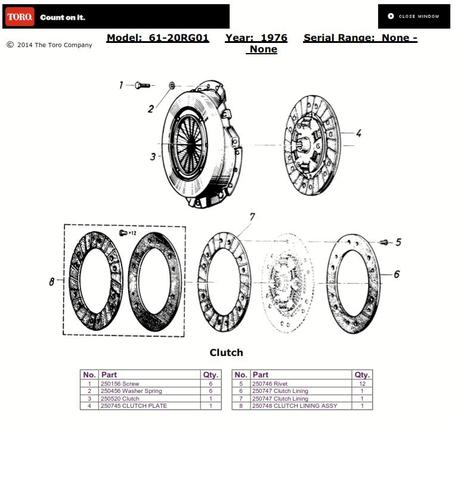

D250power 1 #1 Posted January 30, 2015 Can some one tell me if there is a clutch an pressure plate for d250. Is there a part number that would fit , I restored one and I fixed evey thing but that I would appreciate some info that could really use it thanks Wally . Share this post Link to post Share on other sites
gwest_ca-(File Mod) 12,519 #2 Posted January 31, 2015 Here is a 1976 page Garry Share this post Link to post Share on other sites
D250power 1 #3 Posted January 31, 2015 Thanks Garry do u know of a replacement number that would fit from a auto parts store. Thanks wally Share this post Link to post Share on other sites
gwest_ca-(File Mod) 12,519 #4 Posted January 31, 2015 I do not know of a replacement. If you go to an auto parts that can supply rebuilt clutches they should be able to go to their supplier and either find a replacement or send it to them to be rebuilt. Piece of cake for those places because they are doing it all the time. You would need to take the old unit to the jobber so they or their rebuilder can match it up. Once they know the application they may make improvements to it. Used to have this done years ago for everything from small auto types to large rail locomotives. Garry Share this post Link to post Share on other sites

D250power 1 #9 Posted February 8, 2015 Thanks for the help I found a clutch kit in the Uk new in the box for real good price. They have more if someone is looking. The kit is for a Renault R4 dia is 160 mm. Thanks again Wally. Share this post Link to post Share on other sites
