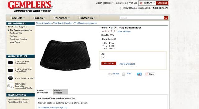

pfrederi 21,306 #3 Posted January 27, 2015 You can buy big repair patches that go on the inside of the tire to protect the tube. Share this post Link to post Share on other sites

zanepetty 117 #5 Posted January 27, 2015 I was most concerned for the spindles and tie rods..I like that patch. I may order one.and, I wasn't around when he did it, tommy. I still haven't seen him 😠Share this post Link to post Share on other sites

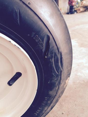

zanepetty 117 #7 Posted January 27, 2015 Here's the damage. Does it look like a Nast hit to you guys? Share this post Link to post Share on other sites
varosd 1,185 #8 Posted January 27, 2015 Ouch! Looks like a bite out of a piece of fudge! I like the idea of a inner wall patch, never seen that before. you are probally fine since its on the front. different story if you had a FEL on it! did the Wheel Horse "kick" back at the ZTR? Share this post Link to post Share on other sites
zanepetty 117 #9 Posted January 27, 2015 Im sure she kicked back😆. She's DEFINITELY a stubborn one. What is a FEL? Share this post Link to post Share on other sites
stevasaurus 23,884 #10 Posted January 27, 2015 A fel is a mounted front end lift bucket. How did he make marks like that Zane? I can understand him going into hiding. Share this post Link to post Share on other sites
slammer302 2,157 #11 Posted January 27, 2015 I would take the tire off the rim and flip it around so that the cuts are facing the inside 1 Share this post Link to post Share on other sites
RedRanger 1,470 #12 Posted January 27, 2015 (edited) Unfortunate, but not that bad. I agree, turn the tire around and put the damage to the inside. Out of sight out of mind. As long as you're not putting extra weight on the front (i.e. loader, weights, blower, etc), you should be fine. How sharp are the edges of the Gravely deck???? Those look like they were cut with a knife. Edited January 27, 2015 by RedRanger Share this post Link to post Share on other sites
zanepetty 117 #13 Posted January 27, 2015 That's what I said! It looks like a knife! I was told it was done with the gravely but not by my brother.. I'm still not so sure.. Do you say it should be ok if I'm not using a loader because it may have weakend the front end components?? Share this post Link to post Share on other sites
RedRanger 1,470 #14 Posted January 27, 2015 That's what I said! It looks like a knife! I was told it was done with the gravely but not by my brother.. I'm still not so sure.. Do you say it should be ok if I'm not using a loader because it may have weakend the front end components?? I don't believe there would be any damage to the front end parts from what I'm seeing. The only damage I could imagine would be the sidewall of the tire has been weakened. If you're just mowing grass and putting around the yard, no issues. If you add additional weight to the front of the tractor, the tire "could" be weakened, and could blow out. Worse case scenario of course. Other than appearance, I would not be concerned, unless your brother coughs up some cash for a new tire of course. It looks worse than it is. Share this post Link to post Share on other sites
