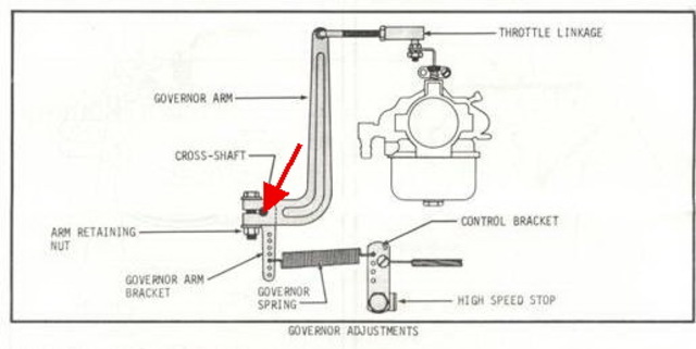

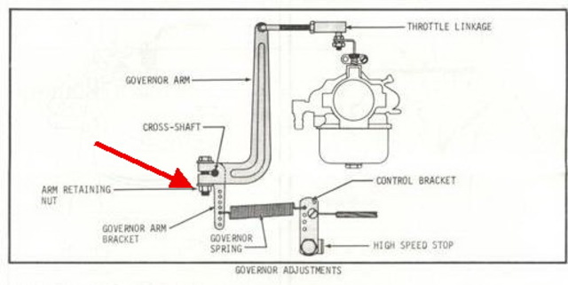

rmaynard 17,443 #4 Posted January 19, 2015 When you have the linkage loose, how much can you rotate the cross-shaft? Share this post Link to post Share on other sites
lobo 23 #5 Posted January 20, 2015 Hello, I went out and checked the rotation and there's not much, less than a 1/4 of a turn. Share this post Link to post Share on other sites
lobo 23 #6 Posted January 22, 2015 How much is the governor shaft suppose to turn when everything is loose? Share this post Link to post Share on other sites
rmaynard 17,443 #7 Posted January 23, 2015 Less than 1/4 turn. I would go back and readjust the governor again according to the directions in the manual. Share this post Link to post Share on other sites
