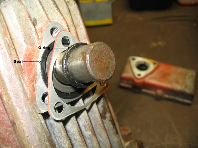

slammer302 2,157 #1 Posted January 18, 2015 My electro 12 seems to be leaking from the cam plate area I was hoping someone can give me an idea on how to fix it and what's needed I just washed it out yesterday and ran it today for 10min and got this puddle Share this post Link to post Share on other sites
ol550 863 #2 Posted January 18, 2015 Martin did a real good thread that included this leak. Just search 'hydro cam leak'. Share this post Link to post Share on other sites

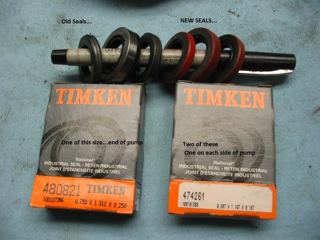

daveoman1966 3,883 #3 Posted January 18, 2015 Either the SEAL is worn or the O-RING is, or both. The seal are Timken and the O-ring you'll have to match at a GOOD hardware store. Timken # 474261 You MAY be able to change these without pulling the pump from the tractor, but I doubt it. The pump isn't to difficult to pull, and you can make a new gasket for it. Share this post Link to post Share on other sites
slammer302 2,157 #4 Posted January 19, 2015 Thanks that helps me understand what I need Share this post Link to post Share on other sites
Trouty56 568 #5 Posted January 19, 2015 (edited) The Charger I have has 2 orings....one around the shaft....and another one that fit in a groove further out..... I replaced both of these orings and that cleared my leak up. I followed Martin's post for mine becuase it looked the same..... Dave...that is good info for seals....just thought the Electra and Charger would have the same setup....and the OP may find 2 orings in there. Edited January 19, 2015 by Trouty56 Share this post Link to post Share on other sites
