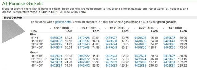

pfrederi 20,869 #14 Posted January 26, 2015 It would seem the gasket thickness would impact clearances on the gearotor charge pump. I still have some parts pumps tomorrow I will see if I can measure any gaskets. I have started using permatex Hi Tack (#9 I believe) in an aerosol can. It doesn't squeeze out and get in bad places like RTV. I will also look to see if I have any of the material wew used to make th gasket. (Never throw anything away ) also looking at Mc Master this stuff may deal beter with higher pressure. I have a sheet I bought but can't remember now what I got it for. (CRS is a real pain!!!!) Share this post Link to post Share on other sites
