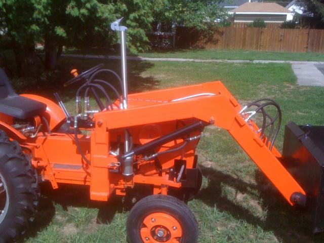

squonk 47,447 #11 Posted January 18, 2015 (edited) I used the bathroom pipe on the original stack. It went on the outside of the muffler but fit good. I liked the look and flapper but did not like the soot on the hood at start up. I ended up making a stack with emt and added a modified turn out to the top like kiwi's.I again went on the outside of the muffler and double clamped it. Here's a short vid of AMC Rules on my Power King with the other stack I'll try to get a close up of it today Edited January 18, 2015 by squonk Share this post Link to post Share on other sites
zanepetty 117 #12 Posted January 19, 2015 The soot is what annoys me! I also added a turn out for that reason. Love the power king! Share this post Link to post Share on other sites
