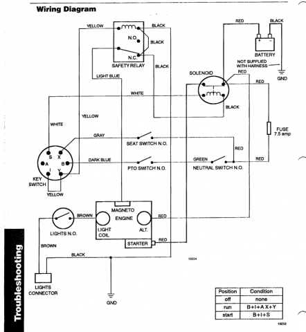

rmaynard 17,495 #2 Posted January 14, 2015 Your engine should have an alternator. I don't know for sure, but I think it is under the flywheel. From the alternator, a wire with a diode goes to the battery to keep it charged. Here is a wiring diagram for the charge circuit. Share this post Link to post Share on other sites
DDuplechin 0 #3 Posted January 14, 2015 (edited) could this black and red wire coming from under the flywheel be part of the wiring to charge the battery? The black and red wires connect to the one of the harnesses you see in the pic, they connect to a orange wire and a blue-purple wire. I tried following the purple/orange wires and think they may come to this set of fuses, all fuses are good. I also see there is a terminal block with a large red cover and a heavy guage wire that leads back towards the battery. at the top of the pic is another connection that has the purple wire leadng to it. Edited January 14, 2015 by DDuplechin Share this post Link to post Share on other sites
rmaynard 17,495 #4 Posted January 14, 2015 Here is the complete wiring diagram. I don't see any orange or blue/purple, but that doesn't mean that they aren't there. There appears to be a magneto control wire, a wire for the lights, and an alternator wire coming from under the flywheel. As you can see, red wire seems to be the charge circuit wire. Click to enlarge Share this post Link to post Share on other sites

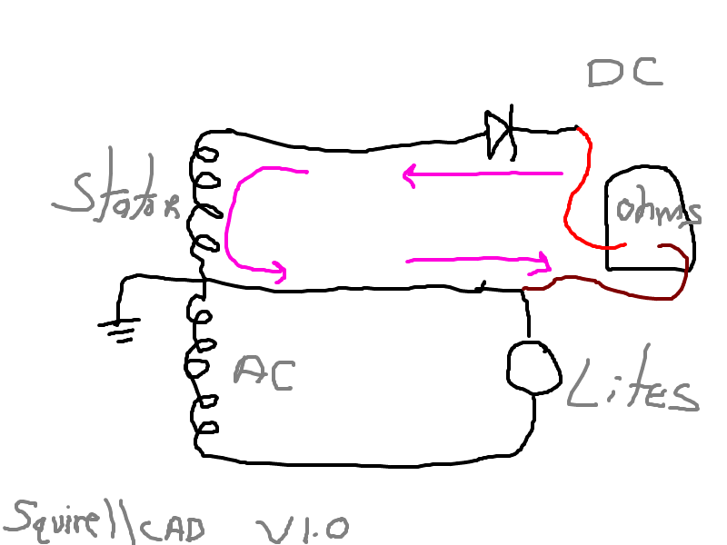

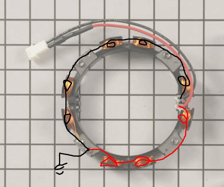

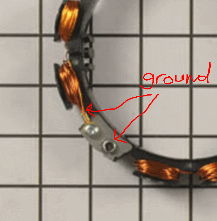

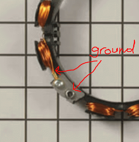

Save Old Iron 1,573 #21 Posted January 17, 2015 (edited) Usually, on a dual stator setup, one end of each stator winding is connected to ground. Instead of measuring across the diode, you should be able to make a diode check by measuring the diode and the stator winding together. The additional resistance of the stator windings would be irrelevant to the results. Connect one meter lead to the diode terminal in the white connector, the other lead to engine ground (or battery ground). Log the ohms reading. Now reverse the meter leads. The ohm meter should read low ohms with leads connected one way and high ohms when the leads of the meter are reversed. The downside to this method is a high reading in both directions could be either a bad diode, bad wiring or an open stator winding. A low reading in both directions is a shorted diode. A 10x or more change in ohms with meter leads swapped would indicate a good diode. The only way to test the diode directly is to remove some of the heat shrink tubing on the diode lead opposite the connector side. Edited January 17, 2015 by Save Old Iron 1 Share this post Link to post Share on other sites
