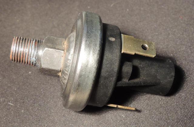

rmaynard 17,440 #1 Posted January 14, 2015 While hunting for the causes of oil leaks on the 416-H, I stumbled upon multiple references on other forums to the fact that the oil pressure switch can leak. Not at the threads, but from the body. Checking the price of a new Onan switch, I am now looking for alternate pressure switches. Does anyone have a suggestion for a cheaper switch? Mine is 2-pole with an internal ground and NC and NO spade terminals. The info on the switch is: Hobbs Corporation Springfield, Il. The numbers stamped on the case are: 80425 5 5 9611 I have tried crossing those numbers with no success. Hobbs was purchased by Honeywell, and when I search the Honeywell site I come up empty. Share this post Link to post Share on other sites

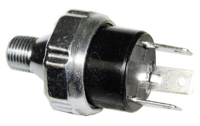

rmaynard 17,440 #3 Posted January 15, 2015 (edited) I have found a PS-122 switch that I think may work. It has 3 terminals. One terminal is common and would need to be connected to ground, One is normally closed which would be connected to the dash light. It opens at 2-7 psi, turning off the light, and the third is normally open. It connects to the hour meter and closes when 2.5-12 psi is reached. That keeps the hour meter from running unless the engine is running. It's only about $5.00. I will only used it if I determine that my original pressure switch is leaking. By the way, Honeywell did get back to me. They have a replacement for the Hobbs switch. The part number is 76582-00700070-01. "NC" opens at 7 psi, and "NO" closes at 7 psi. Trouble is, the price is more than a new Onan switch. Go figure. Edited January 15, 2015 by rmaynard Share this post Link to post Share on other sites
boomers_influence 106 #4 Posted January 15, 2015 bob the problem with the PS-122 switch, in my opinion is TOO MUCH variation as to when it opens and or closes, on each end of the spec. BUT, in the long run it most likely better than NO switch at all. thank you. boomer Share this post Link to post Share on other sites
