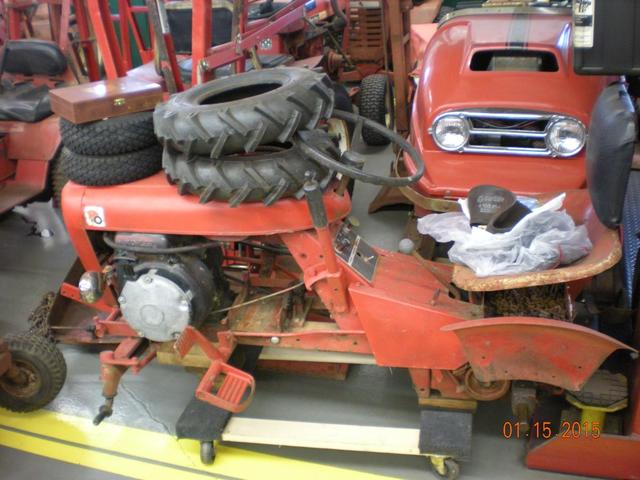

squonk 47,898 #3 Posted January 13, 2015 I have a couple of car wheel dollies that work great. They also come in handy when installing /removing filled tires. No lifting! 1 Share this post Link to post Share on other sites
shallowwatersailor 3,221 #4 Posted January 13, 2015 (edited) I bought a pair of HF 1500 lb. car dollies using a discount coupon when I bought my UFT Mountaineer that had flat tires. They came in handy when I recently needed to move my 312A with the Eaton 700 as well. That way I didn't need to install the battery to run it. The 1000 lb. version are cheaper but have support rods on the ends. Some of the negative reviews involve how they don't roll very well. Just make sure that you lube them before assembling them as the grease is poor. I also drilled holes in the plastic wheel hubs to squirt grease in. They roll very freely now. Edited January 20, 2015 by shallowwatersailor 1 Share this post Link to post Share on other sites

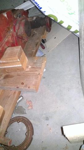

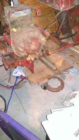

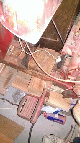

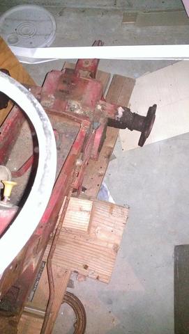

64s 83 #10 Posted January 14, 2015 Hopefully you can see with these pictures. The only one I have in the basement is wedged in. Like I said, this process is not for everyday use, but I slid the dolly under the tractor. Then jack up the front ans slide cribbing under the frame, then jack up the rear and slide in more cribbing. Only takes a few minutes and can be done by one person this way, but I did it mostly to be able to roll a tractor fully against a wall with both tires touching the wall. Share this post Link to post Share on other sites
