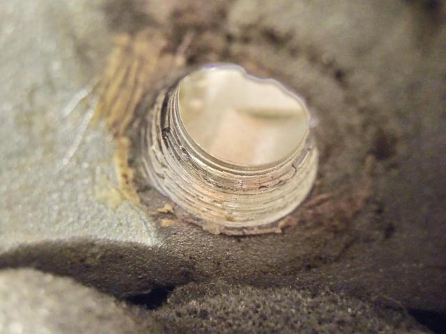

rmaynard 16,552 #6 Posted January 13, 2015 Well this is not what I had hoped for. After seeing the oil dripping from the pan, I was forced to pull the engine again and remove the pan. Doesn't bode well for quick fixes. Here is a picture of what's left of the threads. Digging a little deeper into my pockets, I am now off in search of a replacement oil pan. The good news is that I found no metal or sludge in the bottom of the pan. 1 Share this post Link to post Share on other sites
bmsgaffer 2,054 #7 Posted January 13, 2015 Glad to hear SOME good news! Hopefully you can find an inexpensive used one, there should be plenty of bad Onans floating around that people weren't interested in fixing. Share this post Link to post Share on other sites
rmaynard 16,552 #8 Posted January 13, 2015 That's what I'm hoping. Share this post Link to post Share on other sites
Eric C 109 #9 Posted January 13, 2015 Drill and tap to next size??? Sent from my iPhone using Tapatalk Share this post Link to post Share on other sites
rmaynard 16,552 #10 Posted January 13, 2015 I'm giving that some thought. Share this post Link to post Share on other sites
bobert94 38 #11 Posted January 13, 2015 Since u dont have anything to lose i would suggest JB weld. I had a water leak on my van at the hose fitting in the intake coulnt change it without pulling intake manifold. Hasnt leaked a drop in over 3 years and its under alot more pressure than your drain pipe nipple. Share this post Link to post Share on other sites
rmaynard 16,552 #12 Posted January 13, 2015 Thanks for the suggestion, but I don't use epoxy to repair anything that may be a problem down the road. I have been known to use it for filling dings and small holes, but something as crucial as oil in an engine is another story. At my age, I may forget that I glued the pipe in and try to remove some day. So I decided to drill and re-tap the hole, put a 1/2" to 3/8" adapter in, and use my existing drain pipes. Problem is, I don't have a 1/2" NPT tap. So I call the local Ace Hardware and they have them. $20.00. As I am driving to the store when I get a call from a guy who has a pan from a P-218G off a John Deere 318. Says I can have it for $25.00. So let's see... $20.00 for the tap; $5.00 for the adapter; No brainer. I went with the $25.00 oil pan. Now, as soon as the new pan gasket arrives, I will be okay...I think. Share this post Link to post Share on other sites
