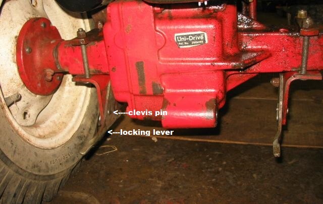

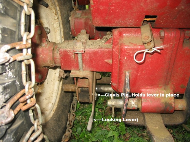

daveoman1966 3,632 #2 Posted January 12, 2015 Look at the rear axle bracket...sounds like the locking lever has come loose on one or both sides. There should be a little clevis pin (with hair pin) to hold the locking lever in place. SOME of these don't have that clevis pin and they rely on the friction of the 3/8 carriage bolt to hold it (them)_ in place. Share this post Link to post Share on other sites

daveoman1966 3,632 #4 Posted January 12, 2015 Yes... When pressure from the frame is put on the locking levers, they will let the round bar flop out of the slot, leading to the frame coming loose and slopping back and forth. You ABSOOLUTELY MUST lock down those two lever to stop this action. If you don't have the 2 clevis pins, just put in a 1/4 - 20 bolt and nut (use nylok nut if you have it.) If the lever is NOT DRILLED, then you only option is to TIGHTEN THE BOLT that holds the lever...VERY TIGHT ! ! !...so that the lever doesn't move at all. If the locking lever and bracket are NOT DRILLED, plan on doing that come spring. Share this post Link to post Share on other sites
