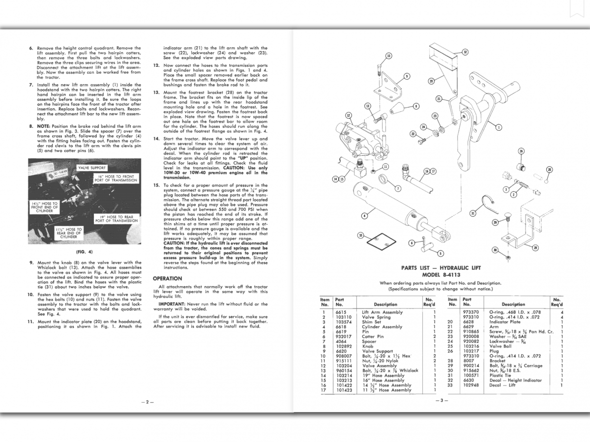

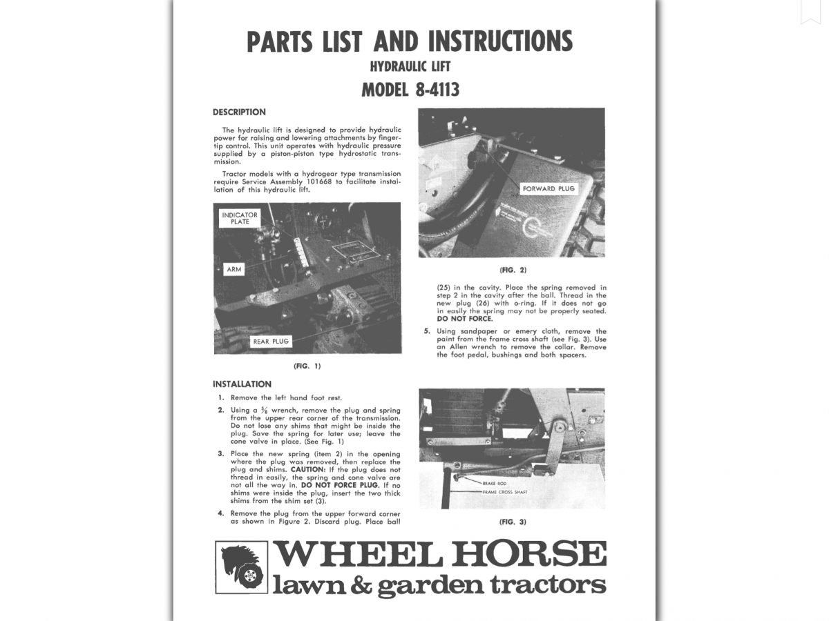

cds105 0 #34 Posted January 26, 2015 Hi Rustynutguy, I may be a little late - but I spent almost a year collecting parts and researching converting my C-120 So I feel your pain! Mine works great ! and tested perfect. Love it for my snow blower I have been meaning to share to save others lots of time and hassle but been wicked busy. Get the Ball # 252490 $ 7.10 and Shim pack # 252470 $ 18.84 from Jacks Small Engines - they had the best price of the three places I found them. Yah you can find that ball for .50 c if you already have one to compair. These parts are worth the 20 bucks in hassel ! follow the intructions from Wheel Horse hydraulic lift Model 8-4113 (google it) or see attached. Wish I had had all your parts- I would have be finished in a jiffy. The cone valves seemed impossibly hard for me to find. Hope this helps you and others ! Carry on. cds105 Share this post Link to post Share on other sites
