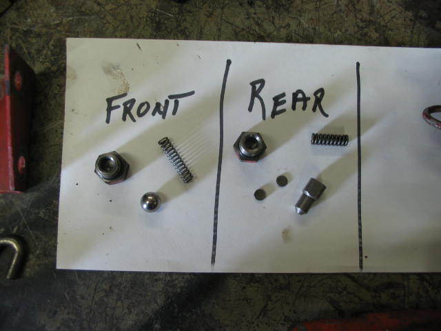

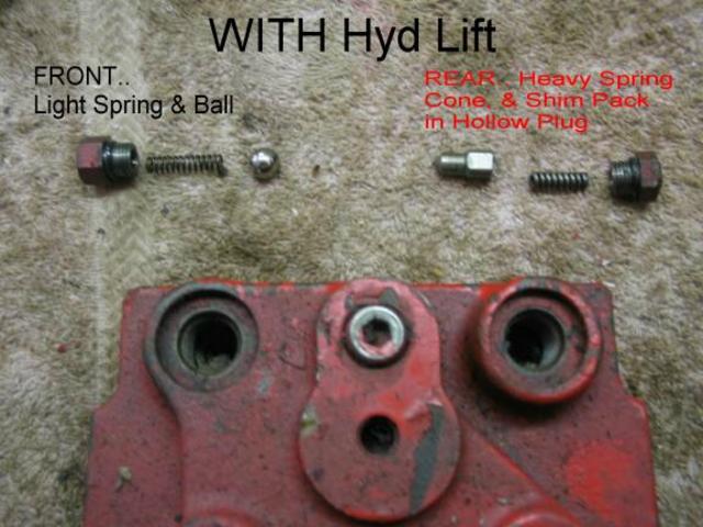

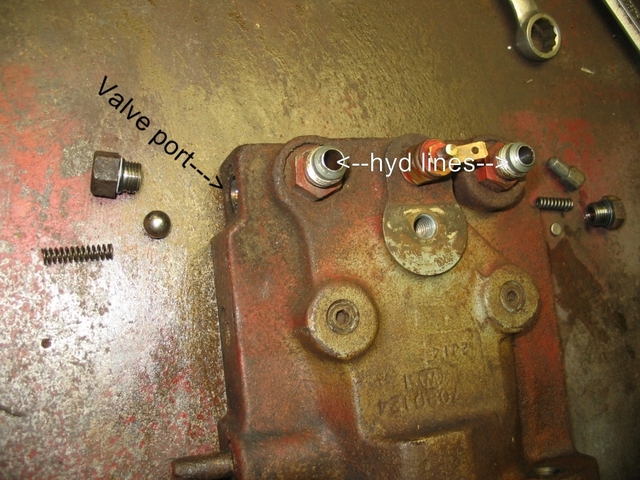

daveoman1966 3,884 #4 Posted January 12, 2015 (edited) End cap spring, cone, & valve components are shown here: Edited January 12, 2015 by daveoman1966 3 Share this post Link to post Share on other sites

daveoman1966 3,884 #6 Posted January 12, 2015 The two hyd lines connect to the FACE of the end cap. The two PORTS for the spring, cone, ball, etc are on the SIDES of the end cap. The ball and spring should already be in your end cap, in the rear port. NEXT.....(1) Remove the rear port plug and withdraw the ball and spring. (2) Remove the front port plug and put that ball and LIGHT spring in there. (3) Install the shorter HEAVIER spring and cone in the rear port. 5 Share this post Link to post Share on other sites

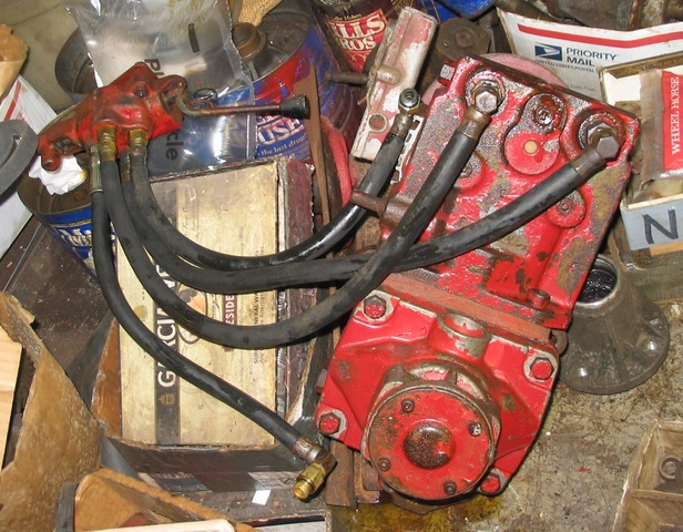

daveoman1966 3,884 #10 Posted January 12, 2015 Get the springs RIGHT. The front port should be a LIGHT-DUTY spring, a little longer than the rear port. The rear port should have the HEAVIER SHORTER spring. Get thIS RIGHT or your hydro lift won't work right. Do you need all 4 lines? If so, what model tractor are you working on? ? ? I probably have them. send me a direct email to: daveoman@windstream.net Share this post Link to post Share on other sites
rustynutguy 9 #11 Posted January 12, 2015 I need the one that go to the tranny cause the ones on it aren't big enough to screw into my tranny Share this post Link to post Share on other sites

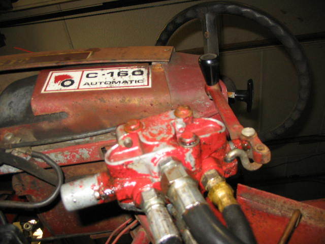

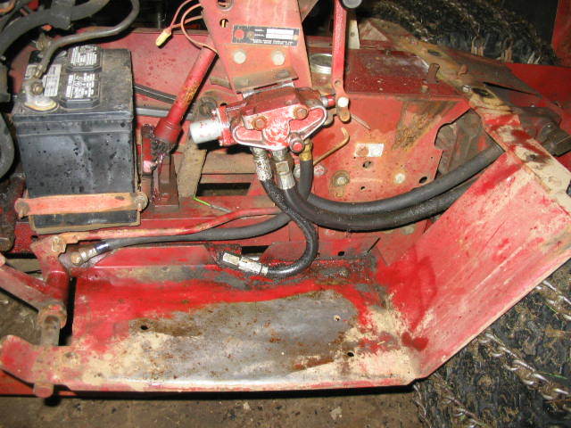

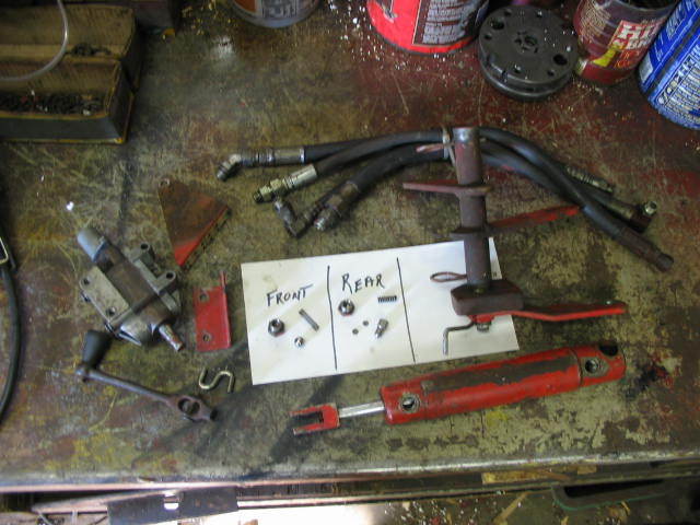

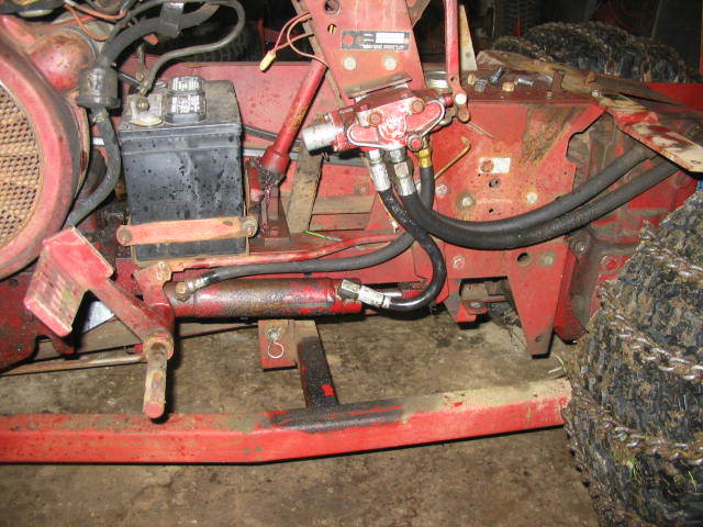

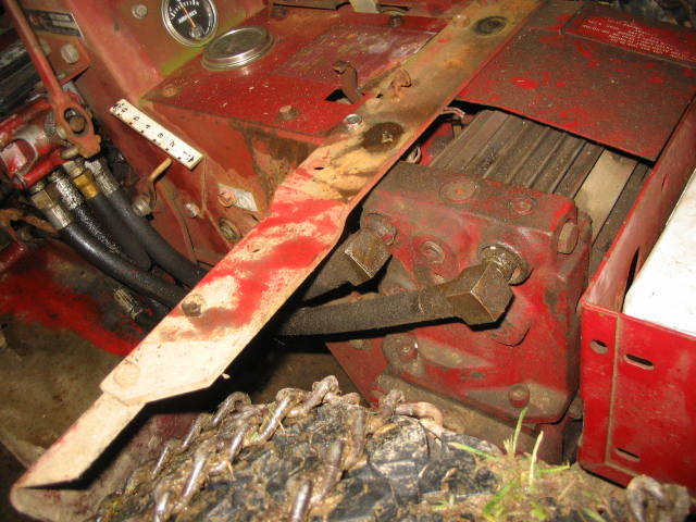

daveoman1966 3,884 #14 Posted January 12, 2015 That MAY be a control valve problem, OR... maybe two cone valves will NOT work right (I thought it MAY work). First, do your hyd lines connect like in this pic of my C-160 (identical to C-120 of 1976 or 1977). If not, switch them around so they do. Looke at the control valve...does moving the handle cause the plunger to move in / out? If not, maybe the little 'S' ring isn't connected correctly or has come loose. Does your control valve look like this one? Share this post Link to post Share on other sites

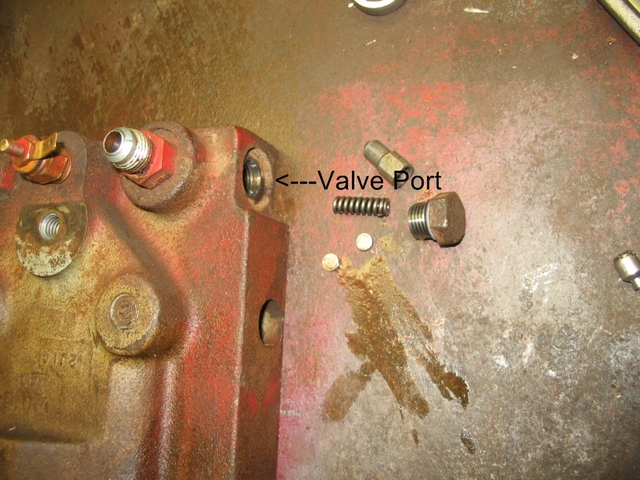

daveoman1966 3,884 #16 Posted January 13, 2015 (edited) I am not sure whether the UP hyd force comes from the front or rear hyd line at the trans. I do know that there is a SHIM PACK that increases the pressure of the rear port (rear hyd line) and it is shown in this pic. Two of them are shown and they are about 1/16" thick and the diameter of the SPRING. The install sequence is: Cone, Heavy Spring, Shim(s), End Plug. You can make the shim....CAREFULLY cut the end off of a bolt that just fits inside the plug....cut it off to just 1/16" length (2 of them). If that doesn't give more lift, then you'll have to find a ball valve for the front port...MAYBE. Edited January 13, 2015 by daveoman1966 Share this post Link to post Share on other sites
