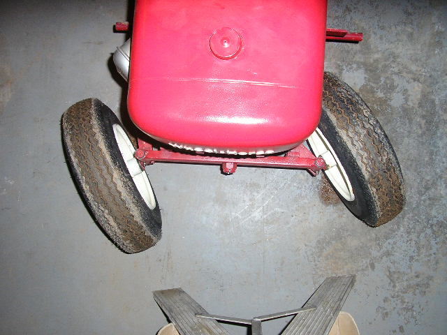

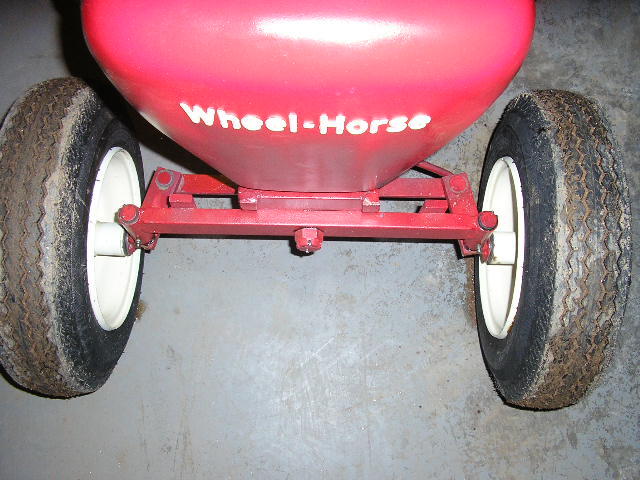

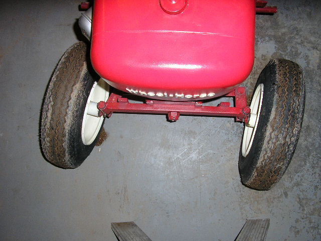

SolarGuru 28 #1 Posted January 10, 2015 First, thanks for the great suggestions on my January 5 post. Installing the belt guard did the trick to allow me to shift from neutral to any gear without grinding gears. The steering though is still crazy. I straightened the tie rod but the wheels still lock up at both extremes. There is, what I think, considerable play in the linkage and is probably the cause of my problem. I also have noticed the front wheels are not parallel. When the left wheel is facing straight forward, the right wheel is facing slightly to the right. Also, the extremes in steering to the right and left are 32 degrees and 21 degrees, respectively. Does this say anything about the linkage? I'm wondering if maybe the person who had this horse before me handcrafted a replacement tie rod and got it the wrong length. Any suggestions? Jon Share this post Link to post Share on other sites

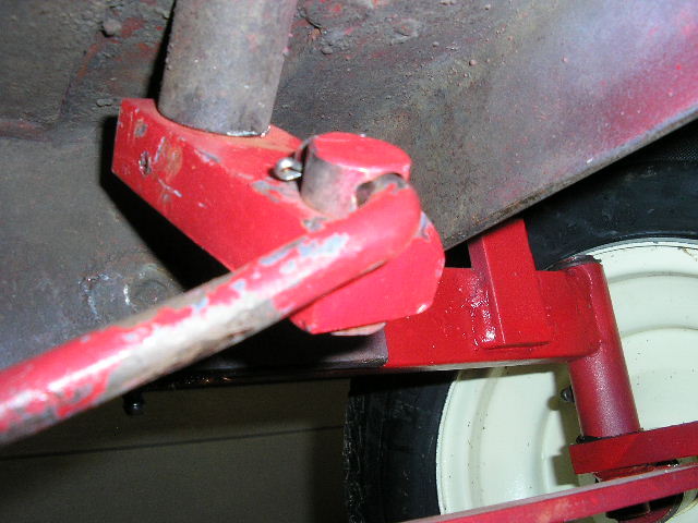

Lane Ranger 12,094 #2 Posted January 10, 2015 (edited) Check you wheel bearings and the pins (round pins with cotter keys Wheel Horse Part #3461 ) that are in the steering linkage under the frame. After 50 plus years they are usually very worn . One of the Red Square members was making and selling the #461 pins -also called clevis pins several months ago . Do a search for SMITTY and you may find a source for these pins. Post some pictures of your front end Jon and we may have some suggestions for you! Edited January 11, 2015 by Lane Ranger Share this post Link to post Share on other sites

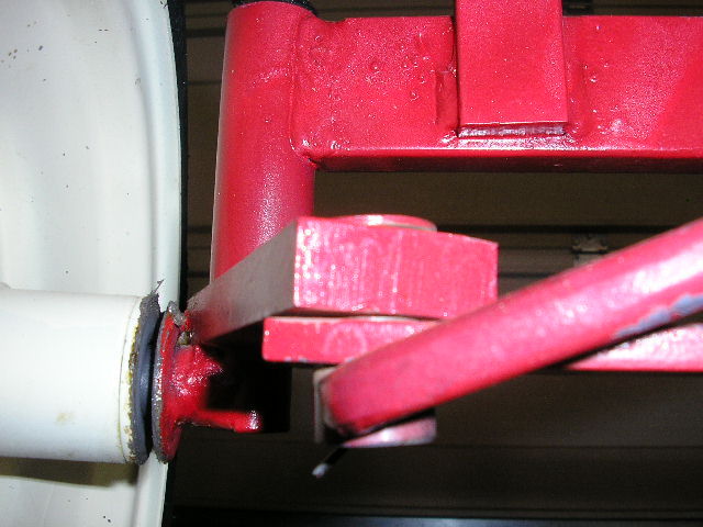

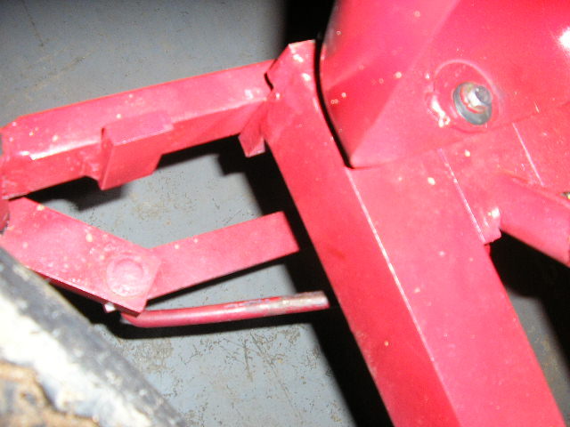

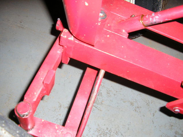

SolarGuru 28 #4 Posted January 11, 2015 Here are five views of the steering. Sorry for the muddy tires. I had just taken a quick spin down the muddy driveway. Yes, the clevis pins are rather lose in their holes. Notice how much more the wheels turn to the left versus turning to the right. Doing a search on Smitty didn't come up with anything. 1 Share this post Link to post Share on other sites
wallfish 20,572 #5 Posted January 11, 2015 (edited) Go here and download the "IPL #A7136" file which shows all the parts. http://www.wheelhorseforum.com/files/download/1880-tractor-1958-1959-rj-58-rj-59-da-om-iplpdf/ It will also show you the correct place for each part. looks like you have the tie rod #12) and the steering block (#67) on upside down. The steering link (#78) is hitting the frame Did you ever straighten the tie rod (#12) if it's bent, that will cause the alignment issue. I can't believe you posted a pic of muddy tires Edited January 11, 2015 by wallfish 2 Share this post Link to post Share on other sites
buckrancher 2,697 #6 Posted January 11, 2015 put a jack under the front of the tractor and lift it up just enough to take the weight off the front end but the tires are still on the ground lay down on the floor and look up at the steering mechanism while someone turns the steering wheel both directions you should see where it's binding if the problem is underneath Brian 2 Share this post Link to post Share on other sites

don355960 1 #9 Posted January 11, 2015 A little hard to tell from the pictures, but could the front axle be on upside down? 1 Share this post Link to post Share on other sites
VinsRJ 724 #10 Posted January 11, 2015 A little hard to tell from the pictures, but could the front axle be on upside down? I think you are right... The steering stops on his tractor are pointing in the up position... not down. Great "how to" video Vin. Thanks man! 1 Share this post Link to post Share on other sites

SolarGuru 28 #12 Posted January 11, 2015 First - great videos and good ideas. Thanks. And yes, the front end is upside down. Wow, what a screw up on my part. I did get the tie rod straightened and it is installed per the diagram. The video shows the tie rod being heated before straightening. Did I mess up again by pounding it back into the straight condition at room temperature? I'll tune the front end turned over and get back to you guys. Thanks so much from a newbe to the art. Jon 2 Share this post Link to post Share on other sites
SolarGuru 28 #13 Posted January 11, 2015 Well guys, I think you've solved my crazy steering problem for me. I turned the front end bar over and the steering now goes to both extremes and hits the stops and can be turned back without locking up. The true test will happen though when I take the horse out for a spin, which I'll do after I repair the leak in the "new" carburetor float I just bought on eBay. Jon 1 Share this post Link to post Share on other sites
