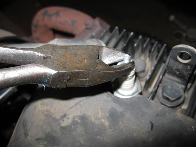

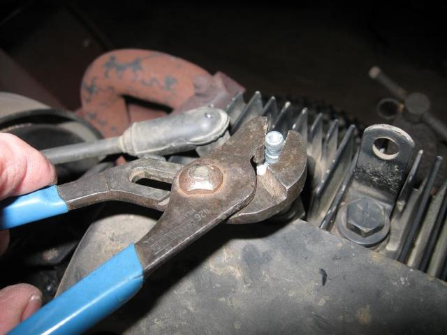

N3PUY 1,031 #1 Posted January 10, 2015 There I was ... plowing the first real snow of the season ... ¼ mile from home at the in-laws and the faithful C125 just laid down and quit with a bladeful of fluffy white snow. The ol' mule hasn't done anything like that in over 15 years. Aw... come-on girl ... back to work. Turned the key .... adjusted the choke and throttle levers ... nope ... not gonna go. I got off and checked the fuel ... even though I knew it was reciently filled ... and it was nearly full. I got back on and tried to coax her back to life ... no way. This is gonna be a long push home ... and it's all up hill. Well, how about a look under the hood? So I stand up and flip up the hood. Woah! The spark plug wire is off of the spark plug! The cap is missing off of the spark plug though. Oh ... it's not missing .... it's in the wire terminal. How's that possible? It screwed off of the plug while captured by the wire terminal. Well, it won't press back on like that ... has to be screwed on. So I took the wire out of the coil, screwed the "wire" onto the plug, reinserted the wire back into the coil. Closed the hood. Turned the key. And we were ready to ride again. How often does that happen? Never ever happened to me before! 3 Share this post Link to post Share on other sites

N3PUY 1,031 #14 Posted January 11, 2015 And here's my solution ..... I just boogered-up the threads and screwed the cap on. I cannot remove it with my fingers now. Should be good for another 15 years! Share this post Link to post Share on other sites
