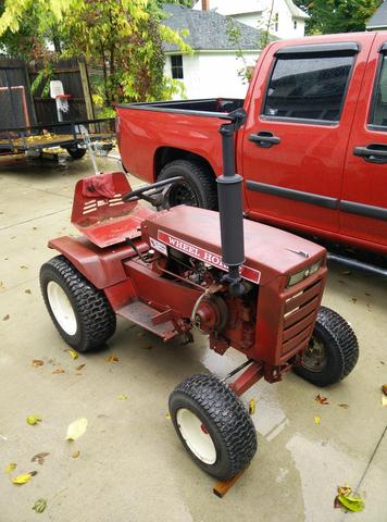

AJ_Thanatos 516 #18 Posted January 16, 2015 (edited) Absolutely nothing Jeff. I was just referring to the two years they were identical in regards to the 77 Bob mentioned. I type too slow to list all the great choices. I believe it was 71 or 72 when they changed to the front mule drive setup which I feel would be a better choice than the older style based on what nrowles is looking for. The earlier C's are an outstanding choice as well. I'm thinking the only difference in the 74-75 was that you got the cool little hood ornament that didn't come on them in 76. And I like the hood ornament! Thats my 74' C-100 with the ornament! Edited January 16, 2015 by AJ_Thanatos 2 Share this post Link to post Share on other sites
