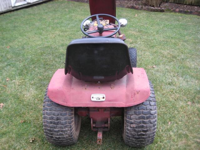

flstf2 3 #1 Posted January 8, 2015 i just became the proud owner of a wheel horse raider 8 i cannot find much information on it what years did they produce them where is the id tags someone did a sloppy repaint with a brush and replaced motor with a 10 hp kohler any help is wanted 1 Share this post Link to post Share on other sites
stevasaurus 23,742 #2 Posted January 8, 2015 (edited) According to the paper work that I have...the Raider 8 was only made in 1972. Model # 1-0330...Kohler 8 hsp engine # K181S-30461D...8 speed Wheel Horse transmission # 5086. (4 pinion differential with 1" axles). Welcome to Red Square With the 10 hsp Kohler in it, you might as well call it a 1972 Raider 10...model # 1-0301...the trans is the same. Here is a picture of my 1972 Raider 10... Edited January 8, 2015 by stevasaurus 5 Share this post Link to post Share on other sites
flstf2 3 #3 Posted January 8, 2015 Is this a good tractor is it worth fixing up? any where to find information on how it should look it is missing the lever for the attachments and not sure what else is missing Share this post Link to post Share on other sites
stevasaurus 23,742 #4 Posted January 8, 2015 It is a great Horse and worth fixing up. You can probably find some more pictures in the Photo Gallery Section on the main page...find the Manuals in the Manuals Section. In my second picture, right behind the lift lever on the dash tower is the model # tag...black and silver. Share this post Link to post Share on other sites

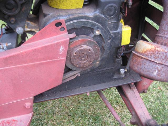

flstf2 3 #19 Posted January 19, 2015 (edited) does anyone have detailed information on how the pto is mounted the motor i have is a K241A Kohler 10 hp motor Edited January 19, 2015 by flstf2 Share this post Link to post Share on other sites

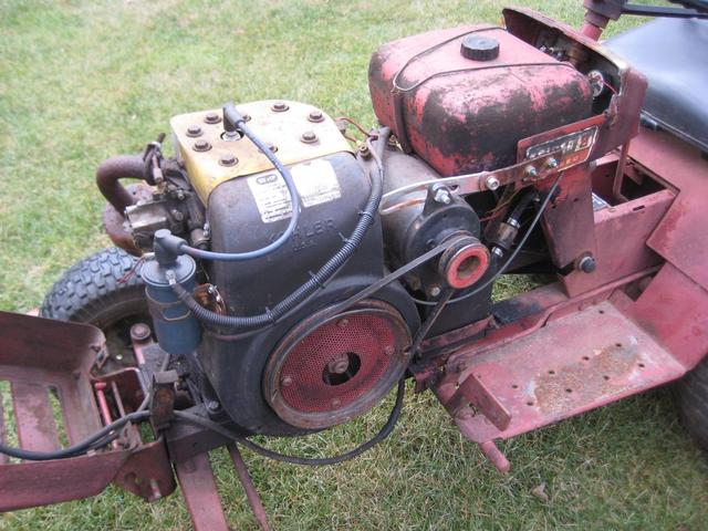

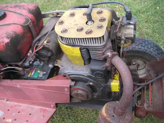

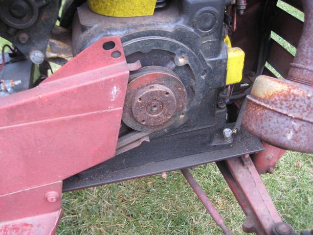

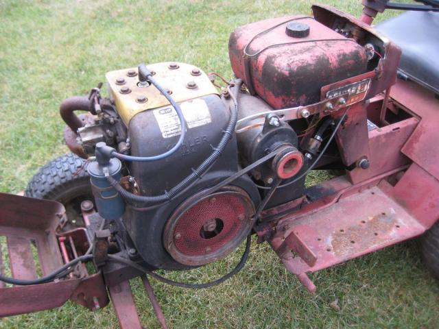

flstf2 3 #20 Posted January 19, 2015 here are a couple pics of my new tractor shown is what i have where the pto attaches 1 Share this post Link to post Share on other sites

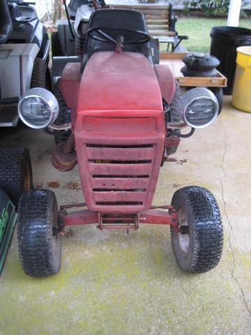

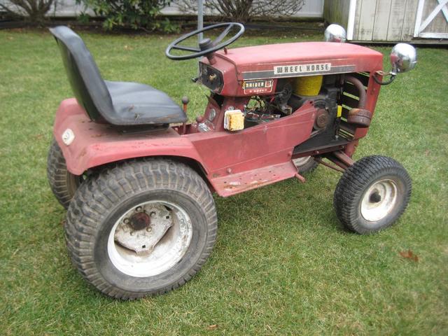

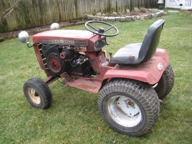

flstf2 3 #21 Posted January 19, 2015 and a few more you can see how someone altered the tractor to make the new motor work i found correct brackets for the generator so the adjustment is on the motor where it belongs not attached to the body Share this post Link to post Share on other sites
flstf2 3 #22 Posted January 21, 2015 can anyone help with pto or what other models parts that will fit the raider ??? Share this post Link to post Share on other sites
gwest_ca-(File Mod) 12,347 #23 Posted January 21, 2015 Your engine crankshaft is not long enough to support the pto clutch. The inner pto race needs to mount on the shaft that normally extends out past the transmission drive pulley. Garry Share this post Link to post Share on other sites
