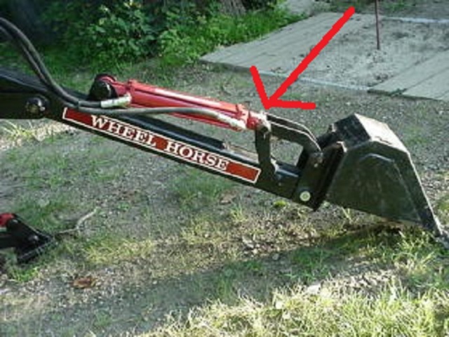

wallfish 20,724 #8 Posted January 10, 2015 Apparently the trick to welding it is not knowing it's an issue. I cut the ears off of all 4 cast steel clevis ends for the cylinder rods on my backhoe and welded on steel tubes. Used the cut cast end so I didn't have to weld tubes directly on to the chrome plated rods. 6 years of hydraulic ram pressure pushing and pulling at full force and never had a problem. I had no idea it could be a problem. Beginners luck! Cast iron is a different story. Share this post Link to post Share on other sites
