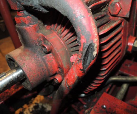

rmaynard 17,634 #1 Posted December 29, 2014 So now that I have the hoodstand removed. I began cleaning the transmission to see where all the oil was coming from. I am more convinced than ever that the previous owner spilled oil when topping off the transmission, and did not have the filter on tight. However, after cleaning off layers of oil, dirt and grass, I removed the crud from the suction tube and discovered this: I don't know how or when that happened, but it is not leaking. Is this a big problem waiting to happen? Share this post Link to post Share on other sites
Desko 687 #2 Posted December 29, 2014 Id say from my point of view it looks like the pulley or something was rubbing but id replace it Share this post Link to post Share on other sites
squonk 48,287 #3 Posted December 30, 2014 (edited) I had something similar on Marvin. If I remember right, the idler or the linkage for it caused it. May even been the belt. It was misaligned and bouncing all over.I had the linkage beefed up and was replacing the trans anyway. Edited December 30, 2014 by squonk Share this post Link to post Share on other sites
rmaynard 17,634 #4 Posted December 30, 2014 I didn't notice it until I had the entire hoodstand and associated parts removed. After I replace the tube and start putting the tractor back together, I will see what could have done the damage. Share this post Link to post Share on other sites
SousaKerry 503 #5 Posted December 30, 2014 Replace immediately!! The only thing second to contamination in destroying a hydraulic pump is sucking air and causing cavitation. If it is leaking out then you can be sure it is leaking air in and pulling in moisture and dirt as well. Hopefully you have caught it before too much damage has been caused. A hydraulic shop can bend you a new one if you take it in, or just find a used one. 1 Share this post Link to post Share on other sites
JERSEYHAWG / Glenn 4,590 #6 Posted December 30, 2014 Imho, yes, a future problem. Glenn Share this post Link to post Share on other sites
rmaynard 17,634 #7 Posted December 30, 2014 (edited) Thanks for the replies. Fortunately, no leak in the tube. Used tube has been purchased. Edited December 30, 2014 by rmaynard Share this post Link to post Share on other sites
