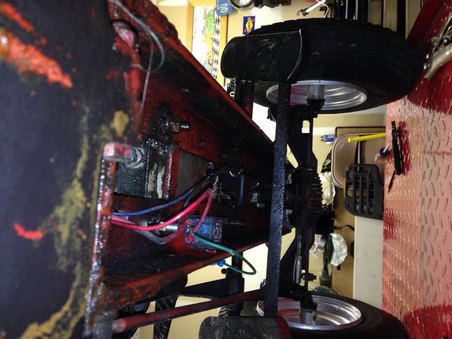

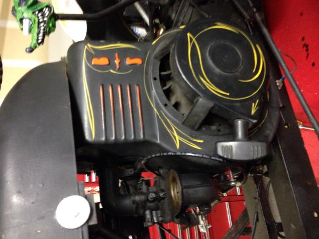

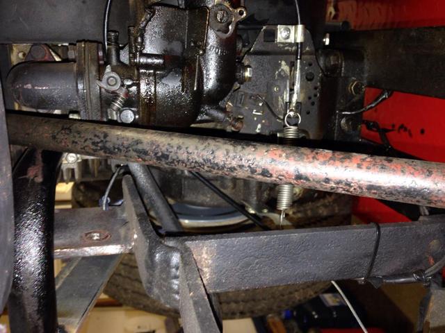

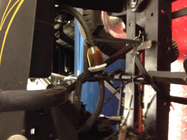

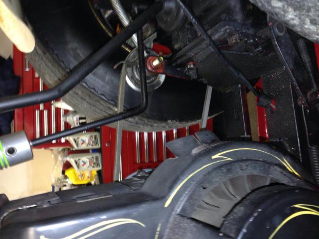

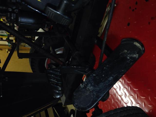

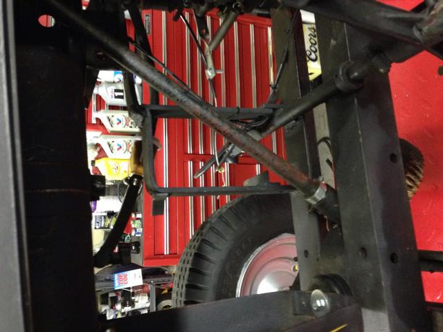

51Chevy 66 #1 Posted December 29, 2014 I'm thinking of outing 2 Briggs and Stratton engins in my suburban. What do you guys think I should do for the steering and fuel tank? Here are some pictures and others for the steering 2 Share this post Link to post Share on other sites

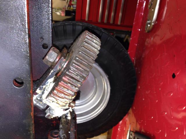

953 nut 70,079 #6 Posted December 30, 2014 If you used the later model "Fan gear" steering shaft mounted vertically through the original hole in the cowl end of the hood and a drag link going forward for steering, and a fuel tank under the seat with a small electric fuel pump you should be able to get a second engine in there! Stretch the frame and hood and who knows how many you could get in there. Share this post Link to post Share on other sites
51Chevy 66 #7 Posted December 30, 2014 That's kind of what I was thinking I had a fan gear laying around and was looking at it tonight I probally can put a universal joint on the sh Stock shaft after the dash tower and tie in the later style steering gear from there... I think that should work. I like your idea of a fuel pump..... Maybe I'll put like a moon fuel tank on the front of the tractor Share this post Link to post Share on other sites
