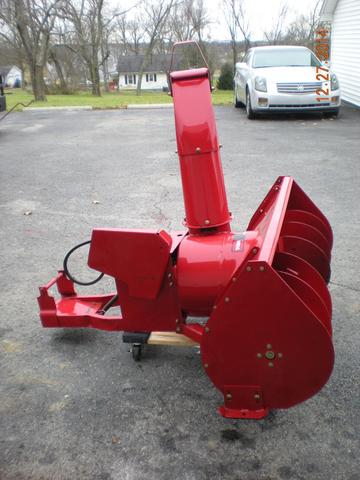

Geno 1,931 #1 Posted December 29, 2014 I got a few more blowers + plows last Saturday and am wondering what the 2 stage will fit. The manual doesn't say and the pics in the manual show it being hooked to a 520 swept axle. Is this the only tractor it will fit? It is a 7900537, 1997 model. Any help would be appreciated. Share this post Link to post Share on other sites
Desko 645 #2 Posted December 29, 2014 No i believe it will fit all the other tractors with the tach a matic system bet its advised to use the 20 hp onan 1 Share this post Link to post Share on other sites
MalMac 1,336 #3 Posted December 29, 2014 Desko is right, but it takes HP to make it work right. It was made for the 20HP. It's best to have it on a hydro lift unless you want to work out your left arm lifting that monstrosity. 1 Share this post Link to post Share on other sites
Forest Road 595 #4 Posted December 29, 2014 (edited) It'll fit anything with attatchamatic. I run mine on a 314H. She struggles with the blower. It's more suited to larger HP tractors. Does that thing have ANY scratches on it? Edited December 29, 2014 by Forest Road 1 Share this post Link to post Share on other sites
Geno 1,931 #5 Posted December 29, 2014 Thanks guys, he said it was used once since new, it has a few scratches behind the auger. Share this post Link to post Share on other sites
baerpath 517 #6 Posted December 29, 2014 It will fit back to a Raider if it has quick attach. Will fit on black hoods but when lifted the shoot hits the hood. A good Kohler 14hp is all I use I've had them on a 520 and wasn't impressed with the little difference in performance. 2 Share this post Link to post Share on other sites

cheesegrader 436 #8 Posted December 30, 2014 The stabilizer bracket and lift-assist spring make it much less of a chore to lift. They also help with steering control and weight distribution. I ran mine on a 520 without them, but it has been a HUGE improvement with them added. (Funny how things work better when you read the manual and attach ALL the parts.) Unfortunately, they are usually the first pieces to be lost! In big drifts, or heavy wet snow, the 2-stage will cause even 20-23 HP machines to bog down. I can't imagine running that monster on the front of a 300 series. 1 Share this post Link to post Share on other sites

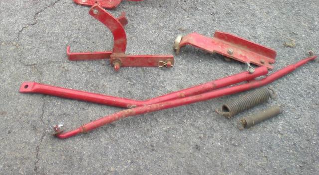

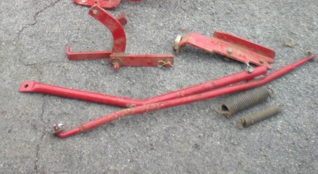

cheesegrader 436 #10 Posted December 30, 2014 The angle iron piece with the round bushing at the end is the stabilizer. Mounts to the right front tractor frame, and stops the thrower from swaying side to side. There should be a shroud that attaches, and covers the belt up to the PTO. The larger 1.5"dia spring is lift assist for the housing. Goes vertically on the right side between a nipple on the frame and a nipple on the box steel mount arm. The short bar with the single bend is the support for the chute rotation handle, goes on a post on the left box steel mount arm. The longer, thinner bar with two bends is the lift arm. The assembly with the curved steel arm is PART of the front lift mechanism that attaches to the front tach-a-matic. Small spring is a mystery, might be the tension spring for the pulleys. 1 Share this post Link to post Share on other sites
Geno 1,931 #11 Posted December 30, 2014 (edited) Thanks Cheese. I have a little shroud with 4 holes in it. Now I know who to call if I run into problems. Edited December 30, 2014 by Geno Share this post Link to post Share on other sites

stevebo-(Moderator) 8,635 #14 Posted December 30, 2014 I just mounted mine up on the 89' 520 without swept forward axle. I need to add some weight to the rear of the tractor to offset the weight of the blower. 1 Share this post Link to post Share on other sites
Red-Bovine 337 #15 Posted December 31, 2014 (edited) The small spring is connected to the lift rod and to the tractor underneath near the connection to the lift cylinder. We have that blower on our 520H (now Honda powered) and it is an awesome blower. Can really throw the snow a long way. There are two rectagular taps that fit on the spring mounts for the lift assist spring. They, and the cotter pins, help keep the spring on. Red Edited December 31, 2014 by Red-Bovine 1 Share this post Link to post Share on other sites
