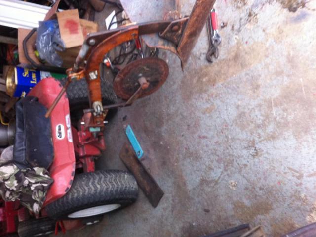

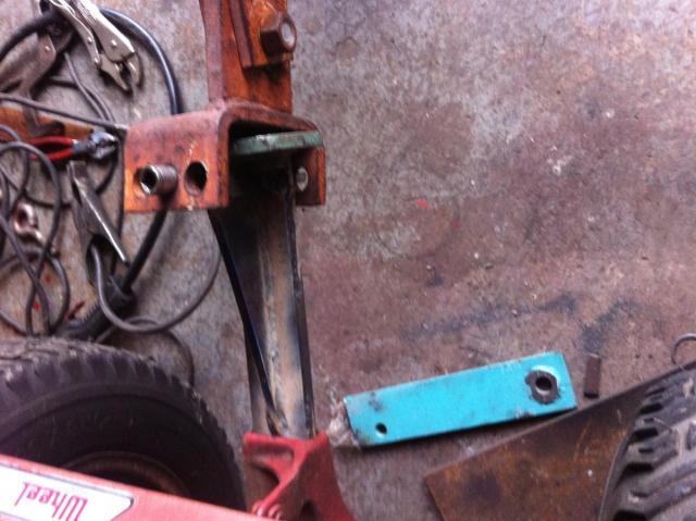

Tristan Wilson 117 #1 Posted December 28, 2014 I finished up my slot hitch adapter today does anybody have the brinly one I think I made mine to long its 11'' long 1 Share this post Link to post Share on other sites
Lane Ranger 10,530 #2 Posted December 28, 2014 Tristan: It is a pretty long neck going into the slot hitch. Those slow hitches are cast and will break under great stress. I think your adapter will pull the brinly type plow connector straight ok but when you get in the earth with a bind a lot of the stress is going to the slot hitch! 1 Share this post Link to post Share on other sites
AMC RULES 36,957 #3 Posted December 28, 2014 Looks really good though... just shorten it up a bit. 1 Share this post Link to post Share on other sites
KC9KAS 4,741 #4 Posted December 28, 2014 I made one that was too short! 3 Share this post Link to post Share on other sites

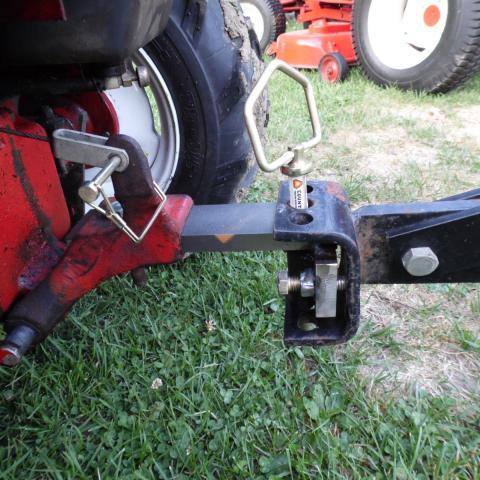

Molon_Labe 731 #5 Posted December 28, 2014 (edited) Here's one I made up with a Brinly plow attached. 2X5/8 stock, the shank is 8" long at the "T". Edited December 28, 2014 by M_Bailey 2 Share this post Link to post Share on other sites

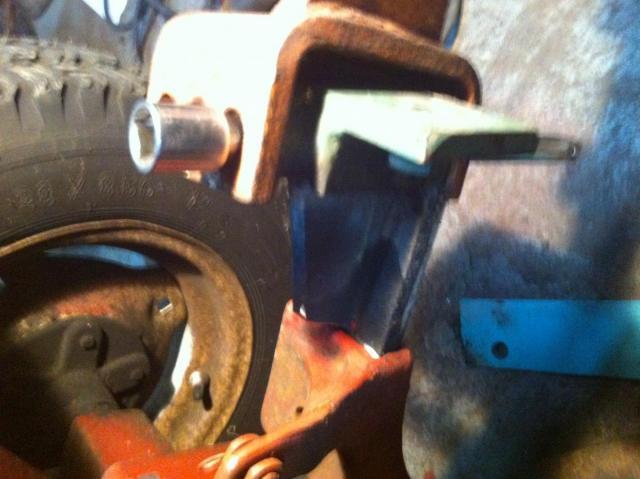

Tristan Wilson 117 #6 Posted December 28, 2014 ok ill cut it down to 8'' or mabey 5'' Share this post Link to post Share on other sites
Tristan Wilson 117 #7 Posted December 28, 2014 ok I went and shorted it up 5 Share this post Link to post Share on other sites
Molon_Labe 731 #8 Posted December 29, 2014 Looks much better! 1 Share this post Link to post Share on other sites
Tristan Wilson 117 #9 Posted December 29, 2014 thanks I cant wait to try it out 2 Share this post Link to post Share on other sites
