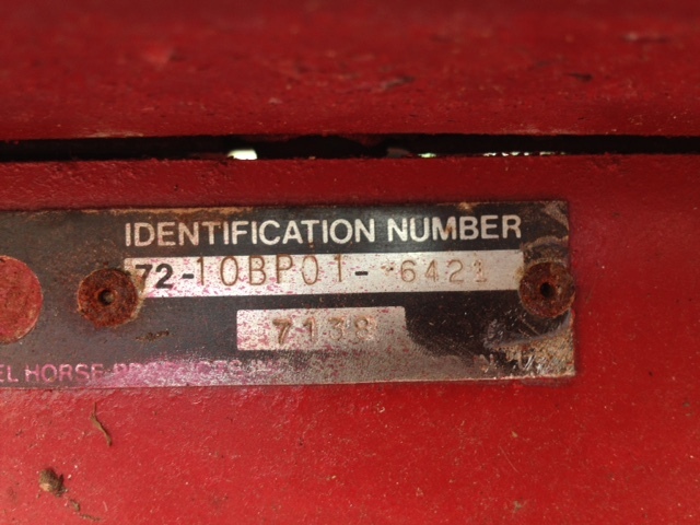

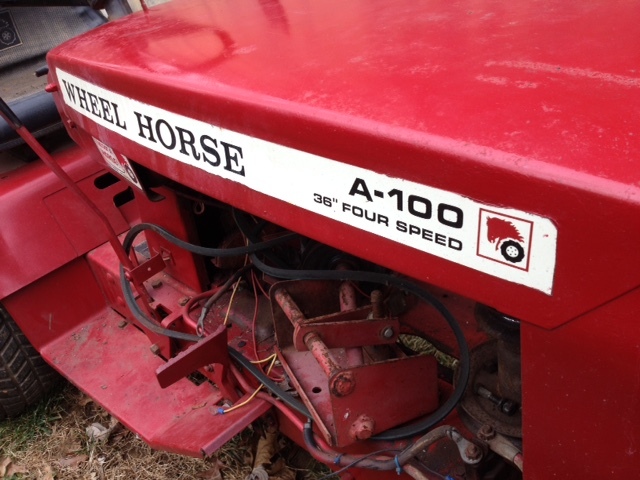

RamTrux 2 #1 Posted December 28, 2014 This is a nice place for info, thanks. I Just picked up a nice lil A-100 last nite. Its missing the motor, but has all the components that I know of. I have the pully combo for the motor, the complete rear discharge deck, and adj pully bracket wirg (2) pullys and shaft with all the belts. Will need to search here for some info on the motor. Thanks again 2 Share this post Link to post Share on other sites

AMC RULES 37,260 #5 Posted December 28, 2014 Nothing but options to fill that hole with... I'm thinkin' a 16hp thumper would do it nicely. Share this post Link to post Share on other sites

km3h 543 #9 Posted December 28, 2014 (edited) Your tractor came with a Briggs and Stratton single cylinder engine, Model number 241707. It is a 10HP engine and a bit hard to find. You can use a Kohler but will need to do a bit of wiring changes which are not difficult. Oh and Welcome to Red Square. Edited December 28, 2014 by km3h Share this post Link to post Share on other sites

scWHhauler 96 #14 Posted December 31, 2014 Welcome!!! and a 12.5 Briggs& Stratton I/C will bolt right in place. Share this post Link to post Share on other sites
jackhammer 553 #15 Posted December 31, 2014 to Red Square.. Nice looking roller you have there. You'll find what you need . Share this post Link to post Share on other sites
