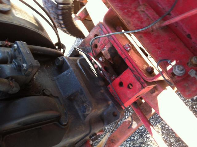

jim3sr 2 #1 Posted December 27, 2014 Can anybody explain why the motor is mounted like this on my newly purchased tractor?Only one side of the motor is secured to the frame,appears the base of motor is too large and extends over frame.I'm puzzled but I"m sure some of you guys will be intrigued.Is a 1987. Share this post Link to post Share on other sites

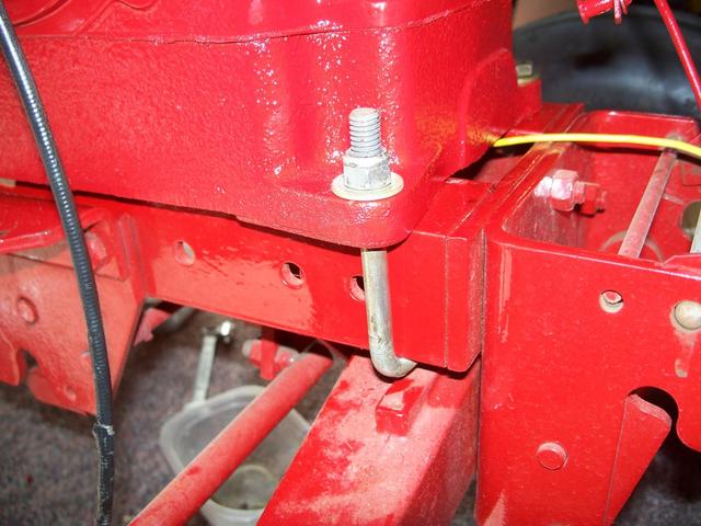

KC9KAS 4,746 #2 Posted December 28, 2014 As you are sitting on the tractor.....The left side has bolts going through the engine base and through the frame with nuts. On the right side, the back hole has a bolt going UP through the frame into the base. The hole you are showing in the photo gets a "J" bolt that has the nut on top of the engine base and the "J" under the frame. Where are my manners..... 1 Share this post Link to post Share on other sites

jim3sr 2 #4 Posted December 28, 2014 I'm not sure i'm following you the pic. was taken from front side (drive belt pulley ect.)There is nothing coming through the holes in the base of motor -I just went outside with a flashlight. Or do you mean the motor is attached underneath to the frame by these 'j' bolts that I cannot see without laying on the ground? Share this post Link to post Share on other sites
doc724 927 #5 Posted December 28, 2014 yes, lay on the ground and look up at the engine form underneath. you will see two bolts going thru the frame into the engine 1 Share this post Link to post Share on other sites
Racinbob 13,286 #6 Posted December 28, 2014 (edited) There's no J hooks needed or used. The oil pan has tapped holes for the right side (PTO side). Bolts come up from under the frame into the tapped holes in the pan. Perfectly correct. Edited December 28, 2014 by Racinbob 2 Share this post Link to post Share on other sites
jim3sr 2 #7 Posted December 28, 2014 so I'm missing a'J'bolt and nut? Share this post Link to post Share on other sites
doc724 927 #8 Posted December 28, 2014 no, nothing is missing 1 Share this post Link to post Share on other sites
Racinbob 13,286 #9 Posted December 28, 2014 (edited) As Doc said, you're in fine shape. Look under the frame and you'll see the bolts into the oil pan on the right side. Edited December 28, 2014 by Racinbob Share this post Link to post Share on other sites
Racinbob 13,286 #10 Posted December 28, 2014 (edited) To elaborate a bit more. The K series big block oil pans Wheel Horse used before the wobble mounts had the holes in the bottom tapped. The left side bolted through the flanges into the frame. The right side has bolts coming up from under the frame. The overhanging holes were normal. Edited December 28, 2014 by Racinbob Share this post Link to post Share on other sites
KC9KAS 4,746 #11 Posted December 28, 2014 My bad.....I see now he is talking about a 310.....I was thinking about my 10 hp on my B-100. Sorry! Share this post Link to post Share on other sites
Racinbob 13,286 #12 Posted December 28, 2014 It's not supposed to be that way on a B-100. Kohler did make the same oil pan without the tapped holes but if that's what you have the motor isn't original. Since you have a right rear tapped hole I'm sure you have a right front. The J hook isn't original but it will work just fine. Share this post Link to post Share on other sites
Kelly 1,038 #13 Posted December 28, 2014 (edited) Yes as said before it bolts front the bottom into the pan on the right side. And YES on the mid frame B series tractors they used a J bolt on the front right corner as there is not room to put a bolt in from the bottom on that frame, but only the B's with the 10 hp and I think that was only 1974 Here is a pic of my sons 1974 B-100 auto, you can see how close the engine is to the front of the frame, because the frame is shorter, and there is no room to install a bolt from the bottom with the axle there. Edited December 28, 2014 by Kelly 1 Share this post Link to post Share on other sites
