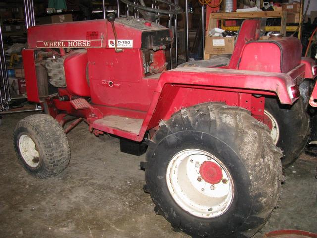

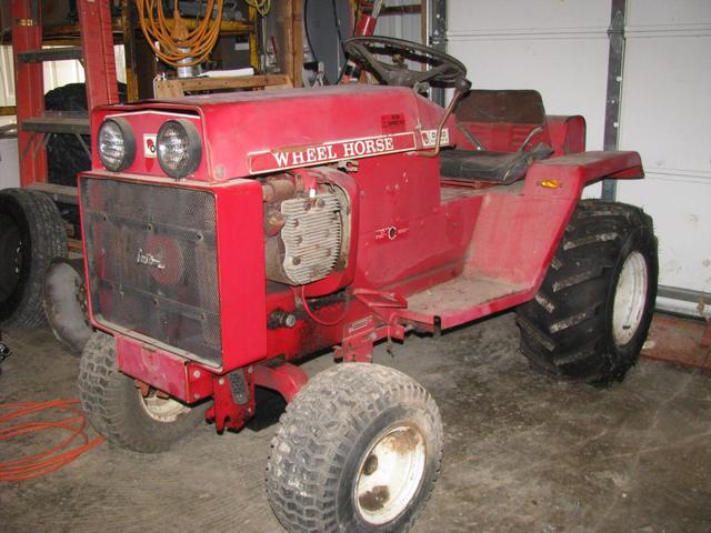

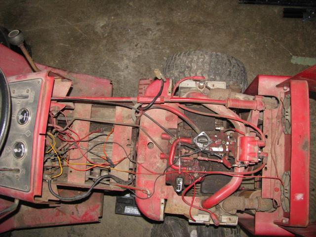

A couple weeks ago, I picked up this D180 and snow blade for $200. It doesn't run because it needs rewired and the air breather put on. The seller still has the air breather which he'll send to me as soon as he finds it. The tractor has hydraulics, drawbar and brand new Carlisle Ag tires on the rear. I would like to get it running but will need some help. First, does anyone have a wiring diagram for a D180? Where can I find a manual for this? Also, where would be a place to get parts for this? The tractor is entirely intact (minus the air breather) except for a couple sheet metal panels which I'd like to put on.

Can't beat that deal....a $200 plow with a free D 180 w/ new ags.

Never owned a D series Horse but, for the price I too would have one. 'Specially in the condition of your new Stallion!

Ivan, you definitely scored a good deal, the wiring  diagram should be in the manuals section on this forum. Did you get the console panel with the I.D. / Serial # tag?   The inlet barb on the side of the carburetor has no fuel filter hose going to it.  The pump control rod is disconnected from  forward/neutral/reverse lever.  Will you be replacing the alligator clip on the coil?  If you need the tins for the engine I have a used set, Mark.

I hope he didn't run it very long without the air filter.

Thanks for the welcome everyone! :thanks:  As one member pointed out from the pics, the ID plate seems to be missing. Would there be anywhere else on the tractor with the serial #?

Only on the ID plate. Post all the numbers of the engine including the serial number and possibly it can be identified using them.
There were only 3 models using the 18hp engine but just 2 model D-180's. The first was named a 1973 18hp Auto.
1974 model 1-0611
1975 model 1-0612
A search of the Manuals using these numbers will get you some info.
A good later service manual also applies to the earlier models

The ID plate would be on another part you are missing - that open spot under the steering wheel should have a cover there and the tag would be riveted to it. If the PO is searching for the air cleaner ask him to also look for it, and also the tin/covers for the engine (those are MUST have parts)

In 1973 they were 18 Automatics.  Starting in 1974 they were re labeled D-180s.  Since it is a D-180, the seat suggests it could be a 1974 or 1975 model year. I believe a different seat was used starting in 1976.  They are beasts.
