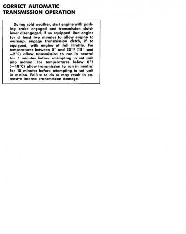

gwest_ca-(File Mod) 10,513 #4 Posted December 26, 2014 From the operator manual Garry 1 Share this post Link to post Share on other sites

smoreau 658 #14 Posted December 27, 2014 (edited) ATF will work in a eaton as I have had 2 tractors that I got had that in them from the PO. The problem with running ATF is whan you tax the trans when its hot you will do internal damage to the pump as ATF doesn't have the lubrication abilitys that engine oil has. I run my tractors HARD sometimes and I hear a lot less growling when the trans is under heavy load and hot with Mobil 1 in them. I have one that woll lift emedatly no mater what the temp is and I have one that takes about 1 min to lift at around 0deg. The one that lifts imediatly had ATF in it when I got it and thats the V Blade tractor. It has 10w30 Mobli 1 know and still lifts at any temp. The other is my Grass cutter 417, It takes about 1 min to lift and before I got it it would take about 8 min without mobil 1. All my other eatons are in the between them If its that cold out, LET IT WARM UP FIRST!!! It doesn't mader what you put in it for fluid ATF or motor oil, It needs a few min to get the fluids flowing for correct operation. Pushing these tractors when its that cold your just asking for problems!! Edited December 27, 2014 by smoreau Share this post Link to post Share on other sites

MalMac 1,328 #17 Posted December 30, 2014 This is a very common problem that most of the Eaton 1100 have. Do not worry about it. Mobil one does help somewhat. I have got several 1100 and each one acts different. Just let it warm up and you will be fine. 1 Share this post Link to post Share on other sites
