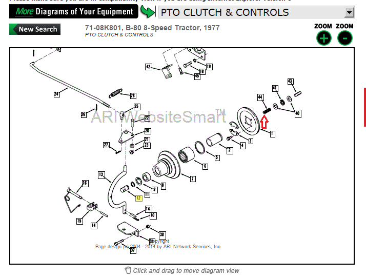

rmaynard 17,443 #3 Posted December 25, 2014 Or are you referring to the PTO brake. If so, be sure that the internal spring (104841) is good and pushing the pulley out when the PTO lever is released. Those springs will get weak or sometimes break. Then with the PTO engaged, tighten the brake pad against the pulley with a .012" feeler gauge between the pulley surface and the pad. That should be all it takes to get the pulley to stop when the PTO is released. If that doesn't work, try .010". If that doesn't work, scuff up the brake pad or get a new one. 1 Share this post Link to post Share on other sites
kudzu3 323 #4 Posted December 25, 2014 Well, I guess that is my problem, there is no spring. Guess I need to find one. Yes, the PTO brake is the one in question, it has a new pad. Thanks Bob. 1 Share this post Link to post Share on other sites

kudzu3 323 #7 Posted January 5, 2015 Thanks, I'll get that ordered. I can't find reference to that spring anywhere, can you reference something to show me where it goes? I believe I have a good idea of the location, just want to be sure. I really appreciate your help. Share this post Link to post Share on other sites
rmaynard 17,443 #8 Posted January 5, 2015 The problem probably is that your 1974 B-80's K-181 has a different spec number than the 1977 B-80's K-181. The parts list that I looked at is from a 1977. If your crankshaft is threaded on the PTO end with a 7/16" hole, then this setup should work. There is a stud, a thrust bearing, 2 thrust washers and a spring. http://www.propartsdirect.net/p/Toro-Lawnmower-Parts?aribrand=TO#/Toro_Consumer/71-08K801%2c_B-80_8-Speed_Tractor%2c_1977/ENGINES/71-08K801-5245-1977/803699-36990035-00010 Share this post Link to post Share on other sites
kudzu3 323 #9 Posted January 6, 2015 Thanks Bob, my diagram does not show the spring (?). I will get the spring ordered tomorrow, thanks very much for your willingness to share your knowledge. Share this post Link to post Share on other sites
rmaynard 17,443 #10 Posted January 6, 2015 No problem. However, before ordering the spring, make sure that you have all the other components, or at least be sure that your crankshaft is drilled and tapped for a 7/16" stud. The spring will be useless if the other parts are not there as well. The stud is expensive, but I made one from a standard lug bolt by putting it in the drill press and grinding the head down to 7/16" diameter. Then I cut a slot in the end with a hacksaw. I think the thrust bearing and washers are still available. Share this post Link to post Share on other sites
