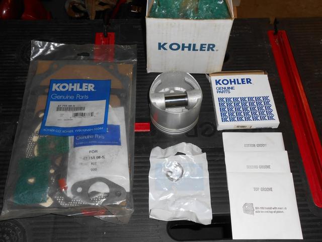

fireman 1,022 #30 Posted January 9, 2015 I decided I want to pull the engine and rebuild it this winter and have it ready for the Spring. I watched Ebay carefully and scored some great deals on what I need to do the job. I grabbed an NOS Kohler complete gasket kit for $20.00 with free shipping ! Then I scored a NOS STD. piston and ring set for $75.00 ! That's half what the Kohler wants. Not sure if it's gonna need valves but I'll see when it's completely dis-assembled. I'm hoping the crankshaft and the rest of the internals are good but we'll see. 5 Share this post Link to post Share on other sites
Geno 1,930 #31 Posted January 9, 2015 Nice price on some good parts! Share this post Link to post Share on other sites
