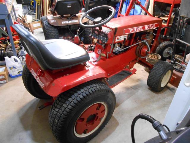

fireman 1,022 #1 Posted December 25, 2014 I quickly used some rubbing compound with a damp rag, then gave it a quick coat of wax to see how the paint looks. It cleaned up pretty good. It smokes when you first start it but clears out after a little while. I think i'm gonna give the engine and quick rebuild. The transmission feels really strong. I'll see if I can con Ken into giving me a hand and see if we can clean up the paint a little more. Someone either broke or modified the brake pedal so i'll replace that. Otherwise that's it. I'll use it for plow duty when there's not enough snow for blower. 19 Share this post Link to post Share on other sites

Wheel-N-It 2,978 #5 Posted December 25, 2014 It now looks like a well cared for working tractor even if it was not. The Simplicity wheel weights are perfect for these machines. They have a great look and add just the right amount of weight for most of the chores a tractor of this size will be asked to do. 1 Share this post Link to post Share on other sites
608KEB 854 #6 Posted December 25, 2014 It cleaned up nicely. 1 Share this post Link to post Share on other sites
fabricator2009 48 #7 Posted December 25, 2014 Well done. I too like the weights. Share this post Link to post Share on other sites
Retired Wrencher 7,036 #8 Posted December 25, 2014 (edited) Very nice looking 12 there Jeff is it a keeper?? and the best part no cradle!!! Gary B.. Edited December 25, 2014 by T1257 Share this post Link to post Share on other sites
Pollack Pete 2,273 #9 Posted December 25, 2014 Hey,that's a great looking C-120.You did a super job cleaning it up.You'll find that the 12 horse Kohler can handle anything you throw at it.Have fun with your new toy and have a Merry Christmas. Share this post Link to post Share on other sites
fireman 1,022 #10 Posted December 25, 2014 I think this will be a keeper. All my other Wheel Horses are restored and for show or cruising only. So I think I'm gonna keep it as it is except some more cleaning. This way I won't feel bad about working it or having it out in any inclement weather. I want to get the engine off and get it torn down and see what it may need. 1 Share this post Link to post Share on other sites

Ken B 3,203 #15 Posted December 25, 2014 That was an awesome score Jeff. It will be interesting to see what you find once you open the engine up. Let me know when you plan to shine it up a little more, I'd be willing to give a hand in that area. I haven't seen too many C-120 hydro's with hydraulic lift myself and I've never seen one that clean. The weights don't look too bad on there, I like the look of Cub Cadet weights painted red myself. It would be worth finding a nice correct seat for that one.. Share this post Link to post Share on other sites
fireman 1,022 #16 Posted December 26, 2014 Yeah it's to bad they're not oem Wheel Horse but they do look good. Got a set of chains with it too. Share this post Link to post Share on other sites
