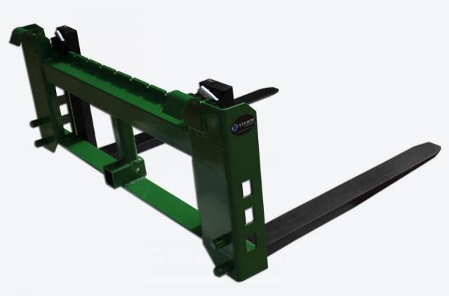

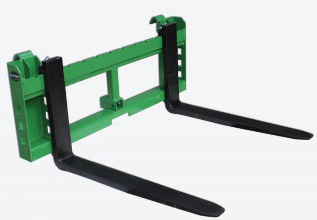

alswagg 128 #7 Posted December 25, 2014 The bucket forks are an option, however the use of these moves the fulcrom point much further forward than neccessary. Thus this will also lower your lifting abilities. here is a version for a John Deere that I was thinking of duplicating for the Ark Loader. here is a back view of the rack. The Ark Bucket has 4 easy to remove pins for exchange. Oh, this set up if 36" width Share this post Link to post Share on other sites
boovuc 1,090 #8 Posted December 25, 2014 I don't think most folks know just how heavy a forklift fork is. I can tell you that both forks and a rack from one of the Clarks and or Nisson Lift trucks at work would tax the lift capacity by itself on my Ark Loader. I believe each fork is about 150 to 170 lbs alone. Share this post Link to post Share on other sites
