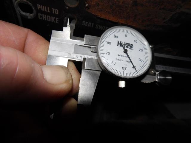

Molon_Labe 731 #2 Posted December 22, 2014 Chuck you never cease amaze me!! I believe the LED would be the way to go to eliminate the lens and rubber grommets (less is better). I currently have 4 of the 5 lenses that came with the tractor and really don't want to go that route if possible. The original design was poor to begin with and the replacement LED is superior in all ways. Another factor is that this tractor will never spend another day outside for as long as it is under my care so moisture ingress would not be a consideration in it's longevity. If it helps here is what the dash panel cutout opening is for the factory lens, .34 inches. Share this post Link to post Share on other sites
Save Old Iron 1,576 #3 Posted December 22, 2014 good deal 0.40 inch = 10+ mm, so a standard 10mm red LED should fit perfectly into the lense holes in the hoodstand. I do have a bag of 10mm's on order, slow boat across the pacific, so they will probably be here in early January. 2 Share this post Link to post Share on other sites
Molon_Labe 731 #4 Posted December 22, 2014 Chuck I think a 10mm would be too large for the hole which measures .34 not .4 inches. or about 8.6mm. The dial caliper in the above pic is in 1/1000 increments added to whatever is shown on the vernier scale. Share this post Link to post Share on other sites

Save Old Iron 1,576 #8 Posted December 23, 2014 Chuck If it helps here is what the dash panel cutout opening is for the factory lens, .34 inches. SAM_0522.JPG Doooh! Sorry about the confusion of 10mm vs 8mm. All the direct readout digital calipers I use make you expect the "final answer" is displayed on the dial. I have both sizes on order and scheduled to arrive any day now. 2 Share this post Link to post Share on other sites

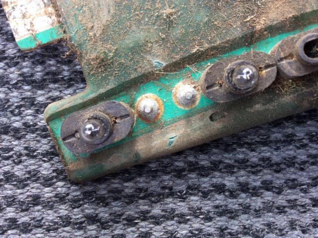

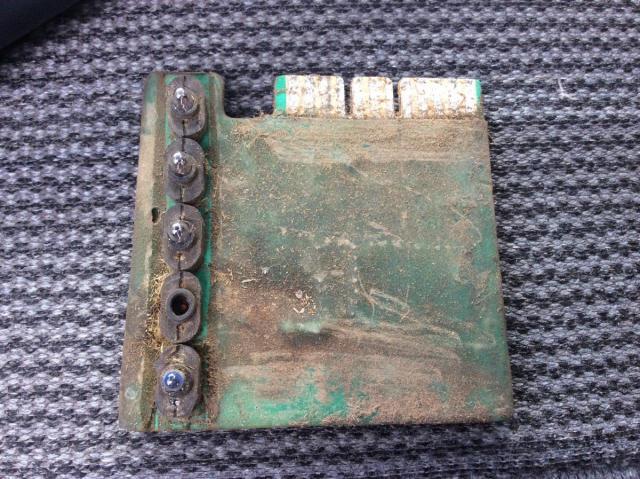

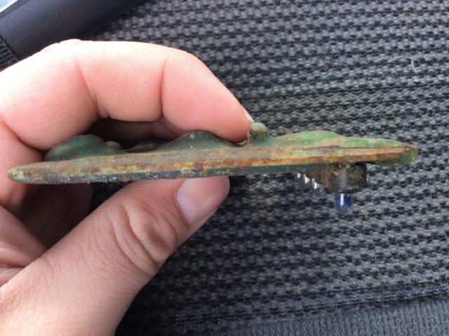

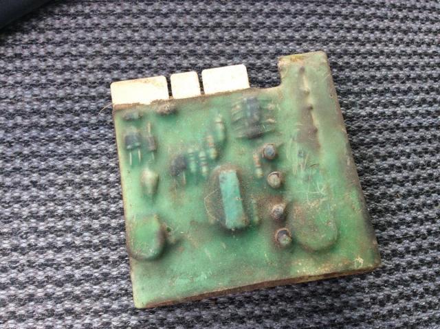

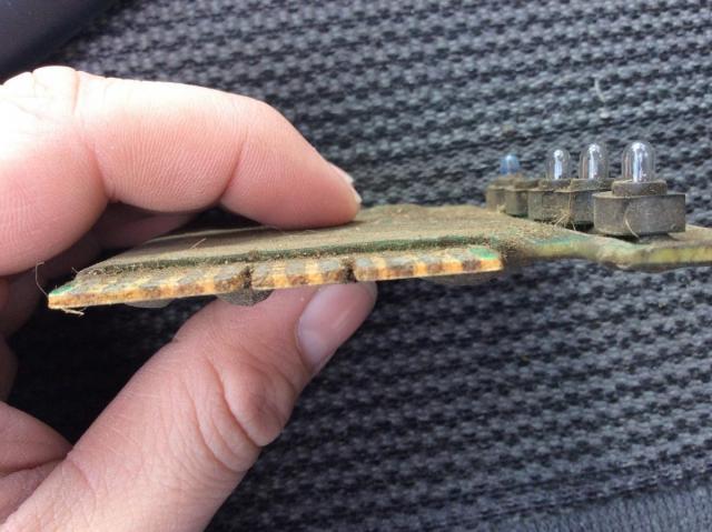

Crown Vic P71 20 #15 Posted January 22, 2015 (edited) I just got a 312-8 and two of the lights always stay on. Both of my safety switches work as they are supposed to leaving me to think its a problem with the board... do you think you could save mine? Edited January 22, 2015 by TractorfanC125 Share this post Link to post Share on other sites
Save Old Iron 1,576 #16 Posted January 23, 2015 We can certainly give the 300 series indicator a look / see. I have not confirmed a 300 series indicator is the exact same as the 400's I have been working with to date. I have not yet confirmed it will function in my test jig but we are about to find out. Yes. I will give it a shot. PM sent. Share this post Link to post Share on other sites
Crown Vic P71 20 #17 Posted January 23, 2015 Thank you! I sent a PM in reply! Share this post Link to post Share on other sites
Coadster32 793 #18 Posted January 23, 2015 Amazing is the right word.. Great work Chuck!! Share this post Link to post Share on other sites
Crown Vic P71 20 #19 Posted January 23, 2015 Here are some pictures of the board. Share this post Link to post Share on other sites
Save Old Iron 1,576 #20 Posted January 24, 2015 Looks like a well preserved 1st generation board. Should be no problem to repair. 1 Share this post Link to post Share on other sites
