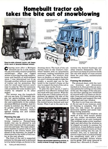

shallowwatersailor 3,222 #5 Posted December 19, 2014 Could you make a frame out of plywood and attach a piece of clear acrylic?This is from Popular Mechanics in 1980. 1 Share this post Link to post Share on other sites
MalMac 1,337 #6 Posted December 19, 2014 Have you ever seen one? If not I have one that when time permits I can take some pic's of. Your best bet in order to get it to fit tight is to have one formed out of sheet metal. Then have a glass company cut you a piece of safety glass and put in the proper rubber seal to fit it. I would think that this would be expensive but if Original Cab Co. still sold them they would not be cheap ether. You might be able to do the plywood or similar thing and fab a way to attach it. Then ask a glass company for their impute on it. Share this post Link to post Share on other sites
