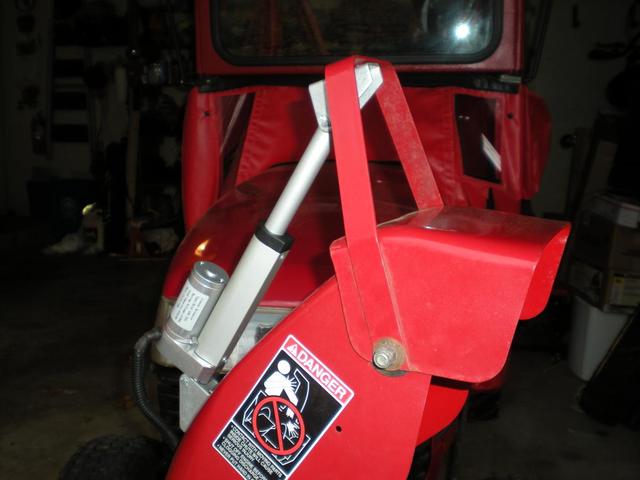

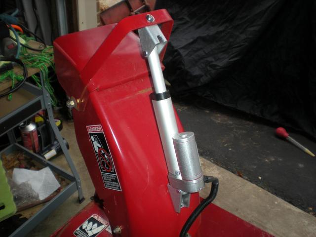

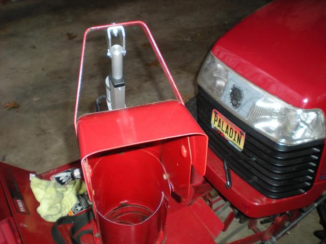

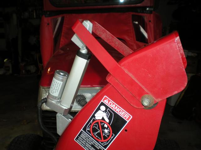

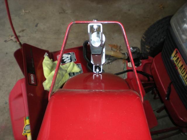

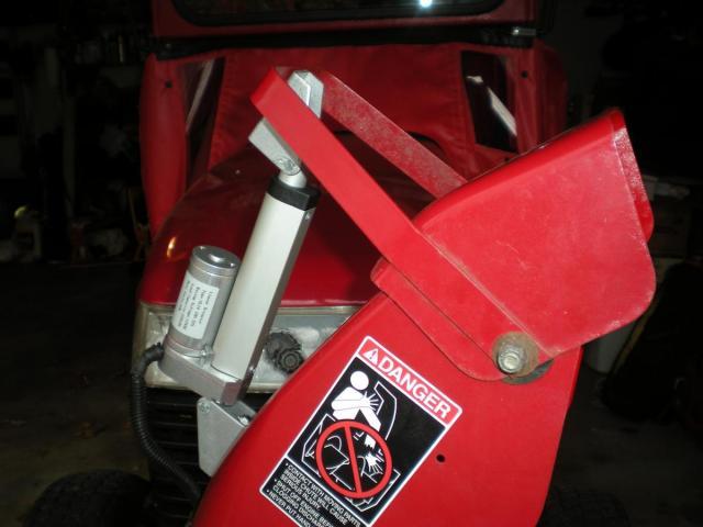

shallowwatersailor 3,220 #1 Posted December 16, 2014 There are a number of other threads on motorizing the chute deflector on the snowthrowers and snowblowers so I won't take any credit. But here is how I did mine with a 4" linear actuator that included the brackets. With the 4" of travel it won't deflect down completely but it should be sufficient. Relatively cheap and strictly bolt-on. I used stainless steel 1/4"-20 socket cap screws inside the chute and locking nuts. 15 Share this post Link to post Share on other sites

the_nite_owl 15 #7 Posted December 16, 2014 There are a number of other threads on motorizing the chute deflector on the snowthrowers and snowblowers so I won't take any credit. But here is how I did mine with a 4" linear actuator that included the brackets. With the 4" of travel it won't deflect down completely but it should be sufficient. Relatively cheap and strictly bolt-on. I used stainless steel 1/4"-20 socket cap screws inside the chute and locking nuts. DSCN2869.JPGDSCN2870.JPGDSCN2872.JPGDSCN2871.JPGDSCN2873.JPG Looks great. How much did you pay for the linear actuator and where did you get it? I want to do the same on several of my tractors with snow blowers. Considering using a power window motor to turn the chute. Have not yet researched what others have done but have seen the setups with the spiral steel for turning, seems a bit overmuch if you have a handle for turning the chute already. I picture adding on a gear for the motor to attach to on the existing shaft. Or use an older snow blower electric starter motor with the throwout to engage the gear so it will still be usable manually. Share this post Link to post Share on other sites

shallowwatersailor 3,220 #10 Posted December 16, 2014 I bought it on the popular auction site. It was $54.95 with free shipping. There are additional lengths available (6", 8", etc.) but what I wanted was one that I could run the full length of travel without over-running and burning out the motor. The limit switches inside stop the motor automatically on this style. The larger black ones, for example, still run but make a ratchet noise. With the 4" I have the full height down to just below level for the discharge. Share this post Link to post Share on other sites

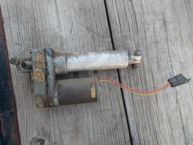

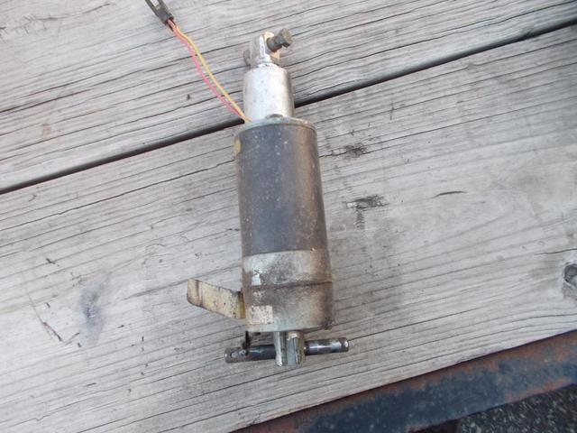

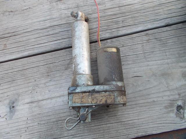

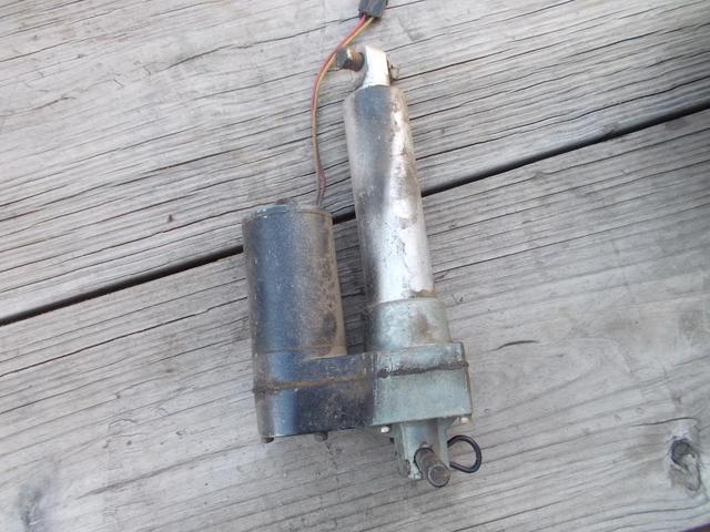

ericj 1,579 #11 Posted December 17, 2014 (edited) i've been wanting to do this to my 2 stage blower because the dang deflector won't stay were you put it. i have an actuator off a crapsman that i parted out. had been trying to sell it, tried to use it last weekend for a project but it wasn't strong enough to do what i needed it to do so now i'll try to use it on my blower. i'll have to make some brackets to mount mine since i got mine used eric j Edited December 17, 2014 by ericj Share this post Link to post Share on other sites
