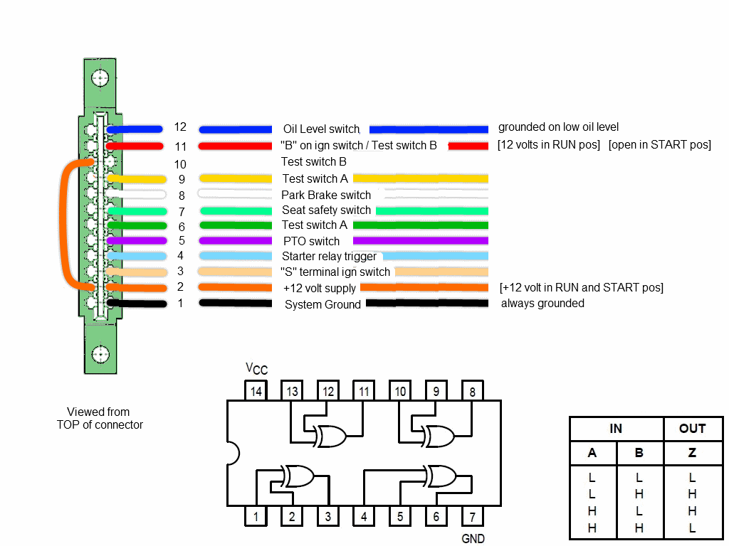

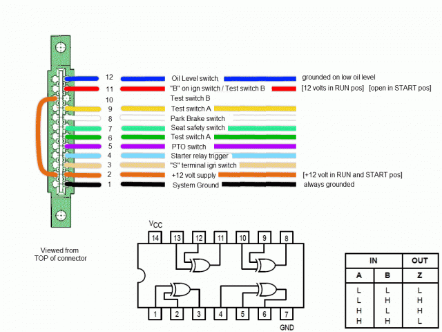

Save Old Iron 1,573 #2 Posted December 15, 2014 I just completed schematics in DipTrace last week for the 2nd gen 418 and the 1st gen 416 pcb's. I can post the schematics here and see if they are readable. The pcb design violates nearly every sensible rule known to sound EE principles. No voltage regulation, running TTL chips directly from 12 vdc, placing + and ground leads next to one another in a "molex meets manure" outdoor environment, no base current limiting on low hfe lamp driver transistors - the parade goes on....... I will look forward to your critique on the design. 4 Share this post Link to post Share on other sites

Save Old Iron 1,573 #4 Posted December 16, 2014 (edited) The 418a schematics DipTrace Schematic - 418a ind pcb test lights schematic.pdf 418A EDGE CONN PINOUT.pdf DipTrace Schematic - 418a ind PARK BRAKE SCHEMATIC.pdf DipTrace Schematic - 418a ind pcb CLUTCH Schematic.pdf DipTrace Schematic - 418a ind pcb PARKING BRAKE schematic.pdf DipTrace Schematic - 418a ind pcb PTO schematic.pdf DipTrace Schematic - 418a ind pcb SEAT SW schematic.pdf Edited December 16, 2014 by Save Old Iron 7 Share this post Link to post Share on other sites
Save Old Iron 1,573 #5 Posted December 16, 2014 some random thoughts ... why bother running the seat and parking brake signals thru logic ? why not just hardwire the lamps directly to the safety switch terminals and have done with it? the whole bill of material for the low oil light could be replaced with a single, self contained flashing LED wired directly to the oil pan switch. my schematics show a 1K ohm base current limit resistor in the schematics - this item is not present on the original pcb and causes some lamps to glow dimly even if the fault is not sensed by the indicator pcb - inserting the 1K resistors resolves the issue. notice the 470R resistor from the +12 volt supply to the VCC of the logic chip. This design actually (attempts) to use the voltage drop across the 470R resistor to supply voltage to the logic chip rated by the manufacturer at 4.7 to 5.1 volts DC. The actual voltage variance seen at the chip under normal circuit operation is 2.3 to 7.2 volts !!!! I removed a filter cap and inserted a 1 watt 5.1 volt zener across the power rails and recalculated the 470 shunt resistor to around 220 - 270R. This keeps the Vcc of the logic chip at 5.1 +/- .15 volts across the entire range of voltage supplied by the battery. The circuit works predictably across a range of 10 to 16 volts at the battery. 3 Share this post Link to post Share on other sites

Save Old Iron 1,573 #9 Posted December 17, 2014 Nick nailed it as the drawings are excellent!!! Now if I could only understand them. Cod Steve, I will give a cursory explanation of how the circuits work to help those who have an interest in learning about electronics. Time wise, the next few weeks are going to be a little tight, so bear with me. 2 Share this post Link to post Share on other sites
