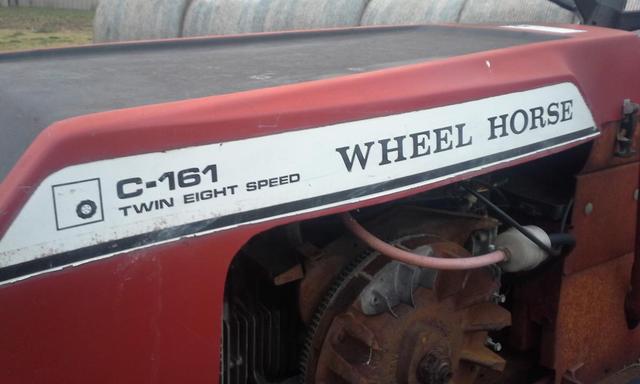

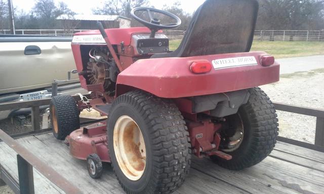

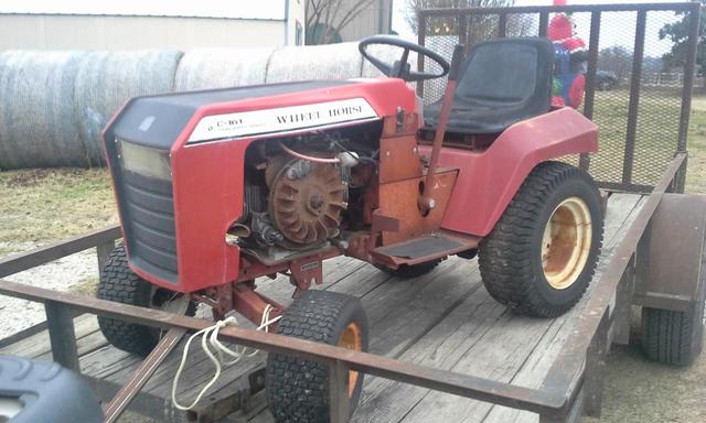

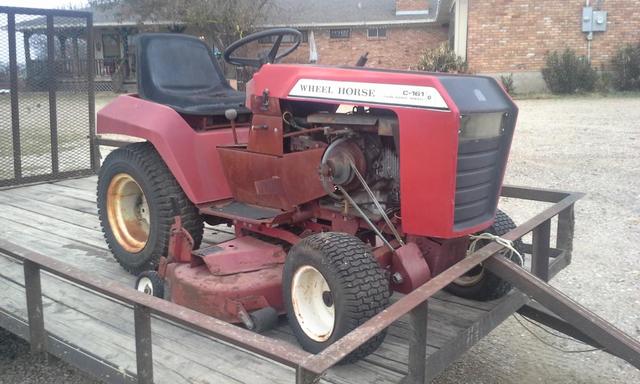

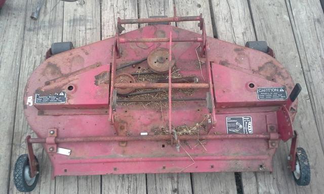

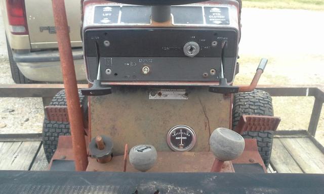

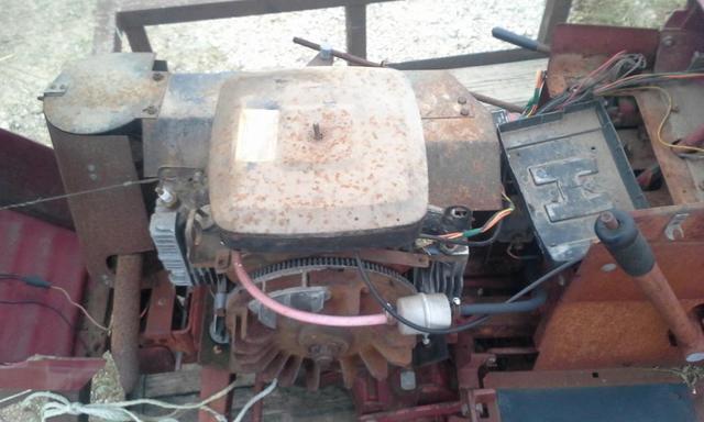

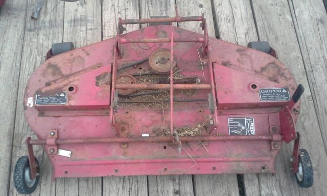

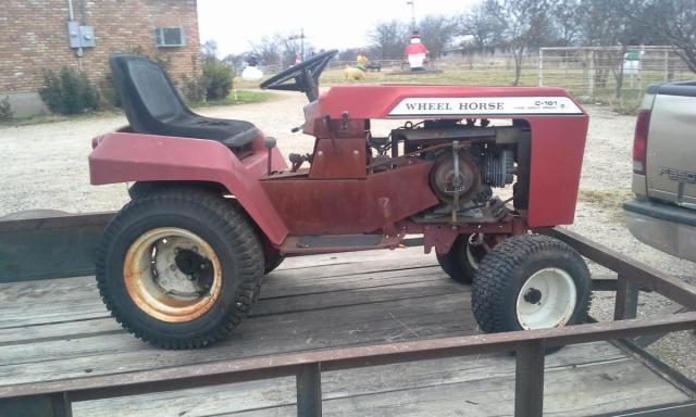

TXMowerSaver 7 #1 Posted December 14, 2014 Hello. This week I traded my 1988 Craftsman III with Onan P220 project tractor for a Wheel Horse C161 Twin 8 Speed project. Me and my friend are happy with the trade, we both had tgese two tractors sitting around not being worked on and we both wanted each others tractor so we did a straight swap. We were asking $100 for each of our tractors sowe just figured heck with it a did a straight trade. He got this tractor in a deal with some others I believe and hasnever done anything with it. When he got it the right side (looking at it from flywheel side) cylinder head was removed as well as the engine tins and coil, not sure why. Engine spins good and the piston and vales operate correctly on the right side, I have not yet had time to remove the other head and see if that side works well. I have a few parts for it already like the engine tins and a coil but I still need to buy a head and the bolts. Should be getting a head tomorrow. The tractor came with a 42" rear discharge deck as well and it is in great shape and all spindles spin good. The fiberglass hood and fenderpan are in great shape with no stress cracks or anything, the hood is a little rough where it meets the dash but not bad. The original headlight lens is gone but a homemade plexiglass lens takes its place. The 8 speed Unidrive unit needs axle seals quite badly. The steering wheel is broken and needs to be replaced. Seat is a little rough as well. Original rear tires hold air fairly well. All in all its a pretty good tractor. I do have some questions tho. What other models have the same steering wheel? Where can I get the bushings for the engine mounting plate? Where can I get axle seals? Thanks in advance for any and all answers to my questions and thanks for reading! I will try and get some photos uploaded soon! 2 Share this post Link to post Share on other sites

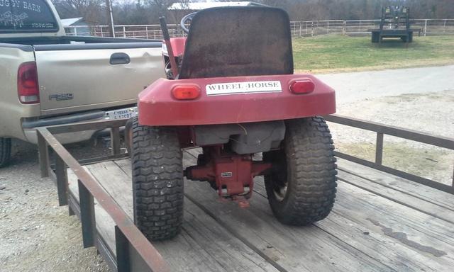

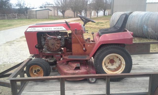

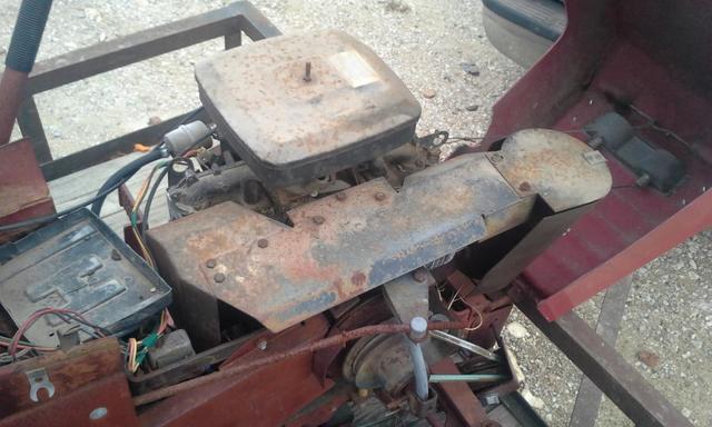

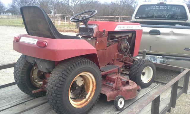

TXMowerSaver 7 #3 Posted December 14, 2014 Photos of my Horse! Also a photo of my Craftsman I traded for it. The fiberglass hoods that are in good condition are rare. And their are sum steering wheels on eBay and I bought the axle seals for my four my commando 8 at a auto parts store Cool! Thanks! 3 Share this post Link to post Share on other sites
ericj 1,580 #4 Posted December 14, 2014 check the valve seats briggs like to pop out as bad or worse then onans eric j 1 Share this post Link to post Share on other sites
TXMowerSaver 7 #5 Posted December 14, 2014 check the valve seats briggs like to pop out as bad or worse then onans eric j Thanks I will give them a good looking over! Share this post Link to post Share on other sites
Molon_Labe 731 #6 Posted December 14, 2014 and thanks for posting the pics. That will make you a nice project. A little TLC and it'll look great. Share this post Link to post Share on other sites
Sparky-(Admin) 26,687 #7 Posted December 14, 2014 Good trade! Make sure you address that loose hub (right rear wheel if your sitting on it) before you start driving it around. Hopefully it hasn't wrecked the axle keyway. Mike............ 1 Share this post Link to post Share on other sites

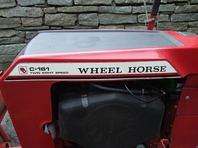

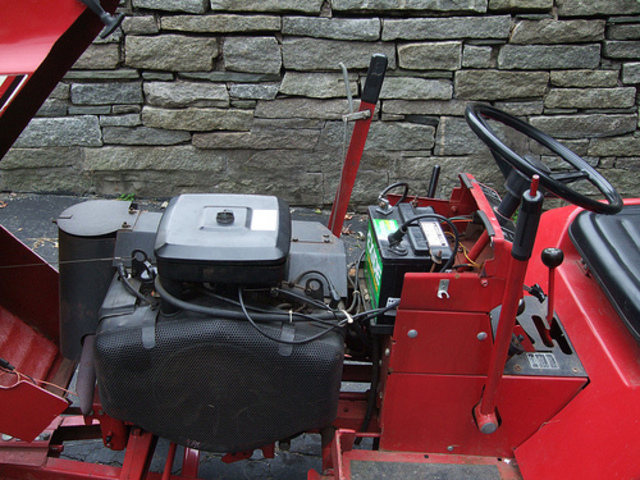

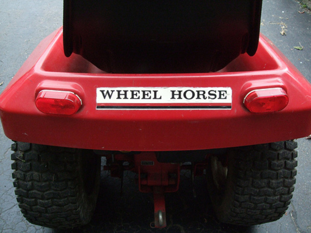

JackC 619 #17 Posted December 14, 2014 I have one of those. The plastic fender is substantially thicker and stronger than the ones on the early 80's C Series. The steering wheel is 13 inch and should be the same as those on all the early 80's C Series. The 1978 and 1979 C-161's were the first black hoods and the only ones with fiberglass hoods. Since the rear fender sits so high, the only appearance mod I am considering for mine is wider rear tires. When you put gas in the tank, you will want a long neck on your gas can because the fill opening is down well below the high rear lip on the fender. Good luck with it. Here is a link to the partstree.com parts diagrams. http://www.partstree.com/parts/?lc=toro_consumer&mn=91-16B802%2C+C-161+Twin+8-Speed+Tractor%2C+1979 Here are some pics of mine. It was well taken care of and it just sits in storage for now. 2 Share this post Link to post Share on other sites
TXMowerSaver 7 #18 Posted December 14, 2014 I have one of those. The plastic fender is substantially thicker and stronger than the ones on the early 80's C Series. The steering wheel is 13 inch and should be the same as those on all the early 80's C Series. The 1978 and 1979 C-161's were the first black hoods and the only ones with fiberglass hoods. Since the rear fender sits so high, the only appearance mod I am considering for mine is wider rear tires. When you put gas in the tank, you will want a long neck on your gas can because the fill opening is down well below the high rear lip on the fender. Good luck with it. Here is a link to the partstree.com parts diagrams. http://www.partstree.com/parts/?lc=toro_consumer&mn=91-16B802%2C+C-161+Twin+8-Speed+Tractor%2C+1979 Here are some pics of mine. It was well taken care of and it just sits in storage for now. 5159620087_f1a6ec3465_b.jpg 4159620609_41ea11303a.jpg 5160373774_b5c1fdb17d_b.jpg 4160368414_58a2374d1a.jpg Wow! Thank you very much! Thats a fine looking tractor too! Share this post Link to post Share on other sites

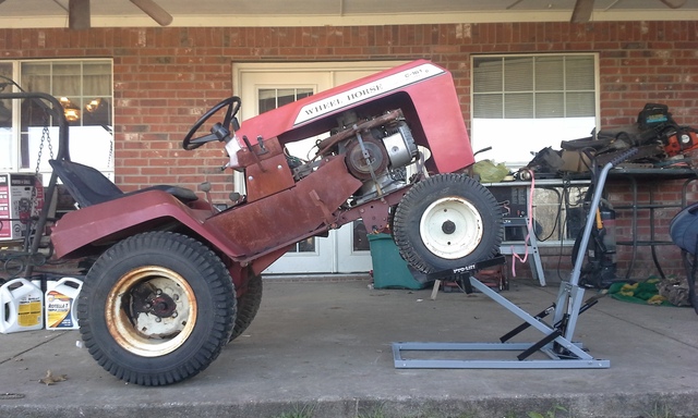

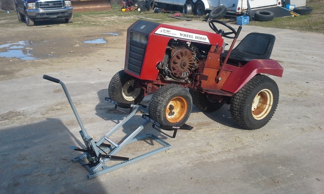

TXMowerSaver 7 #21 Posted December 27, 2014 The Horse got a lift for Christmas! Will make it much easier to work on underneath. Oh I have another question too. Why do my rear axles slide in and out of the casing? I know they should not do this. Trans still works, I mean in neutral it rolls and in gear it doesent. Not sure what it could be? Any help would be appreciated, thanks! 2 Share this post Link to post Share on other sites
baerpath 517 #22 Posted December 27, 2014 Is it the hubs moving ? I see there shoved in. Some play n the axle itself is fine 1/4 inch is okay 1/2 could be a problem Share this post Link to post Share on other sites
oliver2-44 11,816 #23 Posted December 27, 2014 The left axle on my recently acquired (non running) 1979 C-161 hydro also moves out about 1/4" while the right is fairly solid. I'll be interested if you find any problem as it will be a while before I restore mine. It's also interesting that you 79 C-161 has fiberglass black hood and seat pan while mine has sheet metal but matches the rusty pattern of the rest of the tractor. Share this post Link to post Share on other sites
Geno 1,932 #24 Posted December 27, 2014 The lift is very cool. Share this post Link to post Share on other sites
TXMowerSaver 7 #25 Posted December 27, 2014 (edited) The right side axle slid in and out at least an inch, not the hub but the axle. Maybe thats why I have such an oil leak there? Edited December 27, 2014 by TXMowerSaver Share this post Link to post Share on other sites
