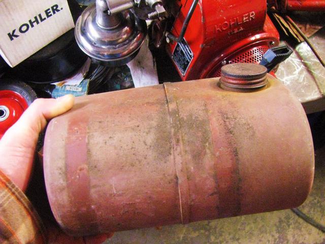

AMC RULES 37,260 #2 Posted December 14, 2014 Can't remember...I know it's based on the location of the fill port... so, is this one pictured a "legit" RJ tank, or no? 1 Share this post Link to post Share on other sites
Racinbob 13,286 #3 Posted December 14, 2014 I really can't say Craig. That looks exactly like the one that came with my Suburban 400. The K91 that was on it wasn't the original and I believe that's the tank that was bolted on the replacement K91. Maybe Wheel Horse bought the engines with the tank then used the tank mounted under the hood Share this post Link to post Share on other sites

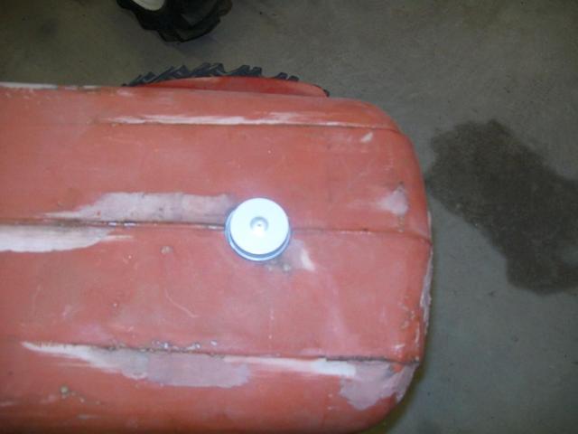

Racinbob 13,286 #8 Posted December 14, 2014 (edited) I was mistaken when I posted that my tank was exactly like the one Craig pictured. My filler neck is about 2" further back, just like the ones on Ebay. Mine has been sitting on a shelf primed and waiting for me to pick up a new filler neck to solder on and I forgot how far back it was until I just now got it down to measure the overall dimensions. It is identical to the Ebay tanks. There is room to accommodate the filler location in either location on a Suburban. I went ahead and bought one of them. I'm thinking the one I have was originally bolted on to motor. Edited December 14, 2014 by Racinbob Share this post Link to post Share on other sites

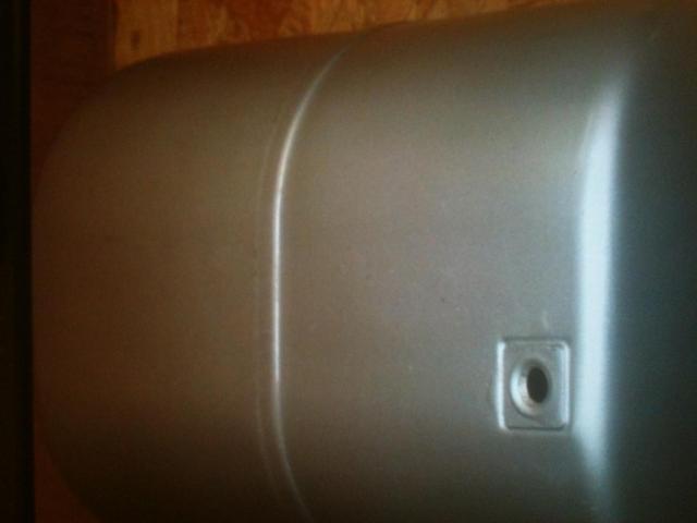

clueless 3,440 #16 Posted December 16, 2014 Got the tank in today. Same size as my burbs, fuel outlet hole up front,damm,didn't show that on ebay! Need to make one in the back of tank or move front strap. Sorry guys. Share this post Link to post Share on other sites
Racinbob 13,286 #17 Posted December 16, 2014 You're talking about the threaded outlet hole on the bottom, right? That would be a problem for me too. There's really no way to tell from the Ebay pictures. Share this post Link to post Share on other sites

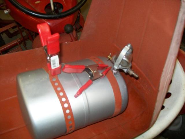

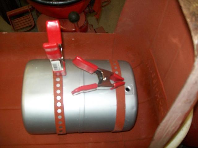

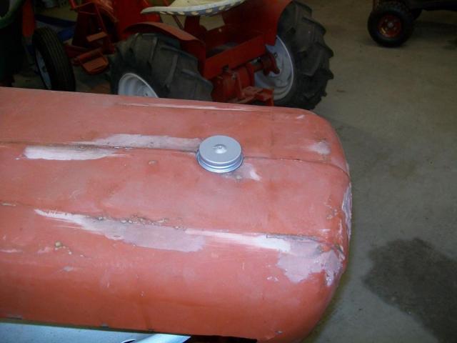

clueless 3,440 #18 Posted December 16, 2014 Bob, I dug up an old hood and played with the tank. Looks like it will work, but if you're going for an original look maybe not. Attached are some pictures of the hood and tank. -Chris 2 Share this post Link to post Share on other sites
Racinbob 13,286 #19 Posted December 16, 2014 Thanks Chris. With the outlet hole so close to the front it likely will work with my straps. The outlet is about 1 3/4" forward of the rear of my old tank and I assumed it was that distance back from the front on the new tanks which wouldn't have worked. My straps are also narrower than yours. The new one is supposed to be delivered Thursday so I'll see then. Worse case I can still get a new filler neck and cap for the old one or transplant the filler neck from the new one. I'm not doing an original look resto on my Suburban. Share this post Link to post Share on other sites
clueless 3,440 #20 Posted December 16, 2014 Yes, original straps are narrower,I think it will work fine. Share this post Link to post Share on other sites

wallfish 20,733 #22 Posted December 17, 2014 Can't remember...I know it's based on the location of the fill port... so, is this one pictured a "legit" RJ tank, or no? That is the correct tank for an RJ, which are much more difficult to find. Suburban tanks fit in the RJ but the straps are the issue 1 Share this post Link to post Share on other sites
Racinbob 13,286 #23 Posted December 17, 2014 Looking at the RJ pictures in the gallery I agree John. Of the ones where you can see the straps, filler and sediment bowl the straps are typically located where Craigs are with the filler close to the end. But there's a couple where the filler is set back more like the NOS and the front strap is forward of the filler. In all cases that I saw the fuel outlet was closer to the back. In any case the NOS tanks are a good deal and would work on RJ's and Suburbans with little modification. 1 Share this post Link to post Share on other sites

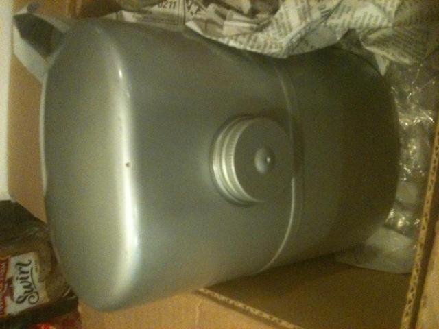

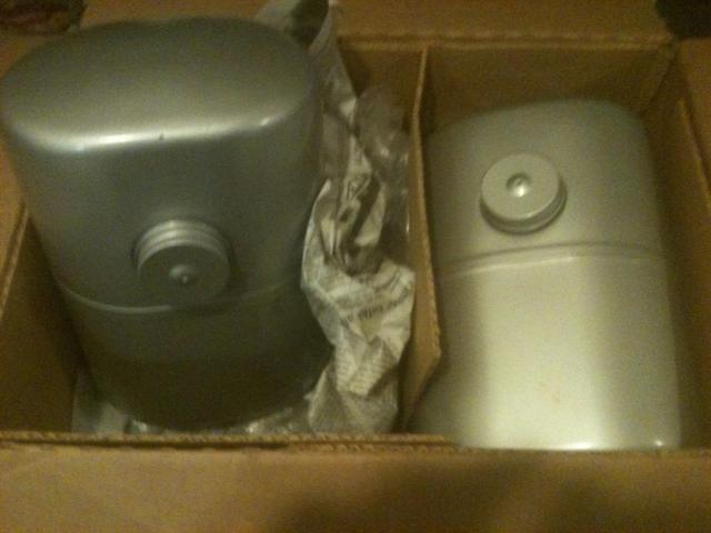

Lane Ranger 12,161 #25 Posted December 17, 2014 (edited) My Two NOS gas tanks came in the mail today! These will fit on RJ and Suburban! Made in 1971 by Chilton in Wisconsin and recently sold on Ebay! I think I can make them work even with the relocated gas filler neck and other differences. I am amazed at NOS is real NOS condition! The seller did post the outlet photo when selling this steel cap version. Edited December 17, 2014 by Lane Ranger 1 Share this post Link to post Share on other sites
