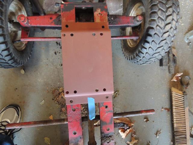

rickinmemphis 1 #1 Posted December 12, 2014 I have disassembled a 1975 C 120 Special to clean and repaint. I was not paying attention when I removed the engine from the engine/frame adapter plate. It looks like I have 4 options in putting it back together. Could someone post pictures of their setup so I will not have to try all of them or at least give me a starting point. Share this post Link to post Share on other sites

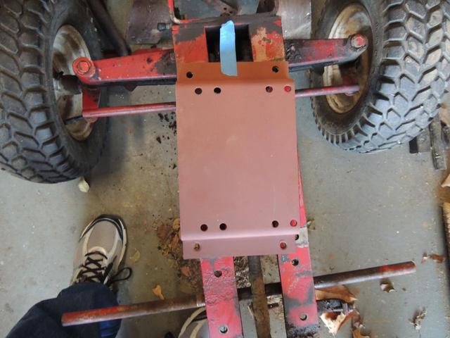

rickinmemphis 1 #3 Posted December 12, 2014 I have a Tecky. I took some Pict and as you can see Blue tape down will bolt to the Frame and Blue tape up will not. So that narrows it down to 2 choices. BTW you did an excellent job in your Restoration. Share this post Link to post Share on other sites
ol550 867 #4 Posted December 12, 2014 (edited) By looking at an HH100 that I have with a mounting plate the tape goes to the rear. Edited December 12, 2014 by ol550 Share this post Link to post Share on other sites
tbarnhart 240 #5 Posted December 13, 2014 I have a OH160 Tecky on my 160 and the plate appears the same. Your first picture(blue tape rear) is correct. The plate is drilled for two different options on the Tecky engines. Some had balance gears which make the pto side cover of the block deeper (about 2.5 inches). These engines use the left set of holes because of the deeper cover and the longer crankshaft. The ones without the balance gears had and shallower cover and consequently moved the engine over to the right (right set of holes). My 160 has the balance gears, but not all the 120's did. Share this post Link to post Share on other sites
