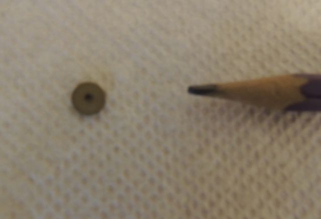

rickinmemphis 1 #1 Posted December 11, 2014 I am putting a overhaul kit in a LME 34. I cannot find were this fiber gasket goes. I did not remove the main nozzle. Help!! Share this post Link to post Share on other sites
Save Old Iron 1,576 #2 Posted December 11, 2014 (edited) (if the original has a felt seal) look under the throttle shaft linkage the throttle plate will need to be removed to allow the throttle shaft to be removed. Edited December 11, 2014 by Save Old Iron Share this post Link to post Share on other sites
buckrancher 2,697 #3 Posted December 12, 2014 looks like the inlet needle seat Brian 2 Share this post Link to post Share on other sites
km3h 543 #4 Posted December 13, 2014 Yep it is the needle seat. You ned to remove the float and the needle, use a hook to remove the old one and a drill bit that will just fit into the tube opening to push it down and against the floor of the tube. If you have an air compressor, you can usually blow it out from the other side. I know because I have blown them clear across the garage and then couldn't find them. Share this post Link to post Share on other sites
rick 323 #5 Posted December 13, 2014 the groove goes down! Share this post Link to post Share on other sites
