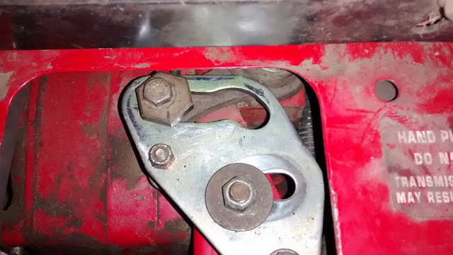

rmaynard 17,314 #1 Posted December 11, 2014 Now that I am the owner of a 416-H, I am starting to work on some of the problems that came along with it. Other than some fluid leaks, the biggest problem is motion control. This tractor has the control lever on the steering column. Here's my problems. When I push the lever forward, the tractor moves forward, but slowly. If I push the lever as far forward as it will go and hold it, it will increase in speed. The action of the lever is not smooth. In other words, it's not a smooth increase in speed as the lever is pushed forward. Having never had any experience with an Eaton, I assume that the speed should increase gradually as the motion control lever is pushed forward, and slow down gradually as the lever is returned to neutral. The same problem occurs in reverse. However, I have to pull the lever hard in reverse in order to make the tractor move any faster than a snail. But when I push the motion control lever forward to the neutral position, there is no neutral area. The tractor misses neutral and goes directly into forward, causing the tractor to jump and jerk forward. I have tightened everything up in the speed cam area, but that did not help much. So here is what my instincts tell me. This is a picture of my existing cam, and this is a new cam that I purchased, Could part of the problem be that the slot where the cam follower rides is worn? Note the tip between forward and reverse is worn down. Any help would be appreciated. Share this post Link to post Share on other sites

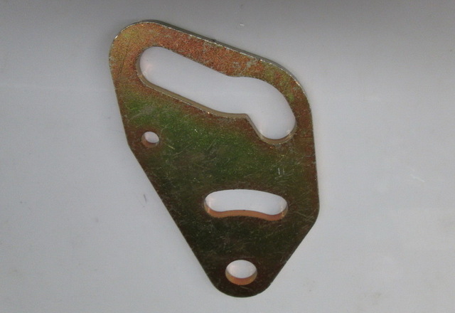

Martin 2,134 #6 Posted December 11, 2014 Bushings, pivots and all wear areas are usually the cause of problems. The cam plate slot wear is a factor too Bob, but the piece that slides through that slot wears as well. Look for flat spots on that piece as it should be round. I had a tractor recently that I couldn't smooth out and it ended up being the stud that the plate you have pictured pivots on. This stud is pressed into a bracket that is bolted to the pump. It had lost its pressed in fit in the bracket and was allowing the plate to rock , not pivot smoothly and bind at the friction washer point. (Keep those friction washers oil and grease free, no lube at all here) Look at each area from the lever all the way back, there is many areas where a small amount of wear all add up. Sent from my iPhone using Tapatalk Share this post Link to post Share on other sites

dennist 139 #8 Posted December 11, 2014 I had one that was having similar issues, tightened all center tunnel linkages and adjusted back and forth still not right, so I spent money on new cam and all that stuff, still not right. I then took off the dash tunnel cover along with seat pan and center tunnel cover, jacked up and started by taking cam off...Started the tractor and made sure it worked smooth and accurate right at pump first. Once that was fine I started to adjust for neutral without linkages "hooked" up, once it was fine I started hooking up linkages and this is where it was problematic for me, the linkages were fine, but up under the dash tunnel watching how it all should work, I found a bolt that held the dash in place was put on backwards and interfering with the motion lever. PO had just been jamming it back and forth instead of finding the main problem. That one bolt was the whole issue that probably angered a few guys to say that those 520's(what this one was)are junk, when it was doing all it could due to that bolt being backwards. It had full smooth motion after that forward neutral and reverse. It really does have to be checked from the column to the pump and all points in between IMO. Good Luck Share this post Link to post Share on other sites
rmaynard 17,314 #9 Posted December 11, 2014 Thanks to all for the info. I will report back what I find (hopefully with pictures). If anyone has a non-worn cam (106661) they would like to sell, let me know. Share this post Link to post Share on other sites
