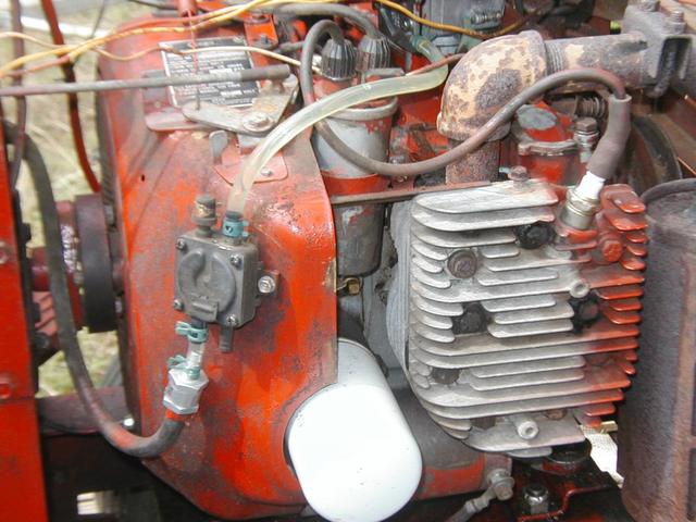

JackC 619 #13 Posted December 12, 2014 Here is a check valve just before the fuel pump on my D-160. I also use clear fuel line so that I can see if there is fuel in the line and how well the fuel is moving to the carburetor. I also no longer use fuel with ethanol which is not good for the diaphragms in the older vacuum and mechanical fuel pumps. I did buy a couple of electric fuel pumps from Amazon for a couple of other tractors. The pumps are Airtex E8016S Electric Fuel Pumps that pump at about 2 to 4 psi. I have not installed one yet but I have a hard starting C-81 that should get one this weekend. The electric pumps are probably the best solution if you want quick starts and are not worried about keeping the original pump style. 2 Share this post Link to post Share on other sites
varosd 1,185 #14 Posted December 12, 2014 JackC That looks like a Boss system! Better than having give the gas tank "kiss" to get the gas back up the fuel line! Share this post Link to post Share on other sites
