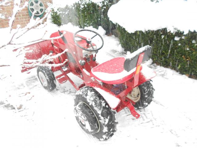

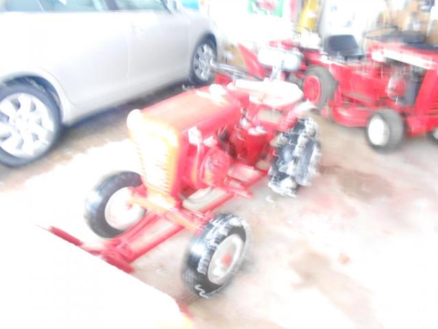

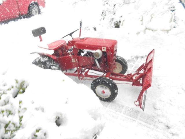

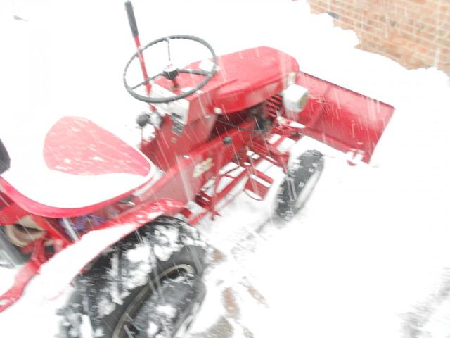

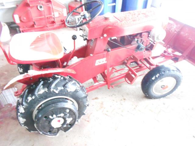

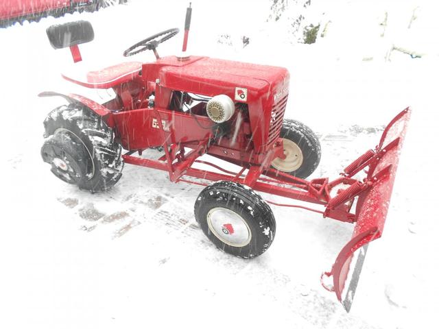

Lane Ranger 12,150 #2 Posted December 11, 2014 Our 633 uses a BD-4262 1962 Wheel Horse plow. These pictures show it in action! The plow has the foot pedal engagement for changing the angle of the plow on the right! I think they made these plows for three years 1962 to 64. Share this post Link to post Share on other sites

octfst 378 #4 Posted December 11, 2014 (edited) The plow on Lane's 633 is the correct plow. But any short frame plow will work. There's a plow that has 2 settings for short or long frame that will also work. The short frame is common used till 1968. The one on Lane's was only used a couple of years & are hard to find. Your 70's plow is a long frame. you could make it work. it would stick out further & would have to change your hook up at the lift point. Edited December 11, 2014 by octfst 1 Share this post Link to post Share on other sites
