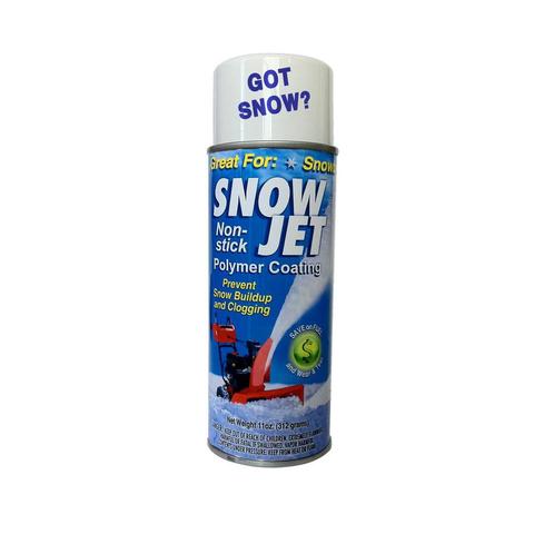

fireman 1,022 #6 Posted December 10, 2014 Hey Pete, try this stuff. Home Depot carries it. I just picked up two cans of it this morning. Lets hope it works as good as they say! 2 Share this post Link to post Share on other sites
RMCIII 840 #7 Posted December 10, 2014 Pete - thought your were talking about the engine. LOL.. Fire- it does, otherwise I would not be supporting it as often as I do..... But here is what I also do. Coat the blower. Let it set a couple days, go out and run the blower, then re-coat it again. Let it set, then a day later coat it a final time. Really allows the stuff to soak in where you may have missed some areas. The biggest areas I coat the most is the throat of the chute, the chute and on either end inside where the snow really has a chance to collect. Rob 1 Share this post Link to post Share on other sites
