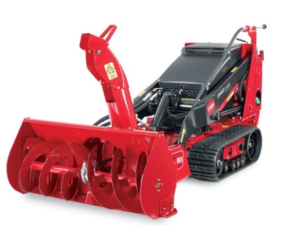

shallowwatersailor 3,221 #14 Posted December 10, 2014 (edited) I know that I did some research about the single-stage snowthrower this summer when I got the one for the 5xi. I that that I saw a rotational speed for the auger, which is why I knew about the retrofit kit to adapt older snowthrowers to the 315-8 equipped with the electric PTO. The only reference that I can find today is for two-stage units which turn the auger much slower. A number sticks in my mind of around 2200 rpm. Would that be possible? By the way, here is the ultimate walk behind Toro snowblower. What I found interesting is the shape. Notice that the design of the snowblower is the same as what the tractors used, including the tall chute (and the notches, Ed.) To put price in perspective, you could buy two Honda HS1332TA ($3K each) for just the price of the snowblower attachment for the tracked Dingo! Edited December 10, 2014 by shallowwatersailor 1 Share this post Link to post Share on other sites
