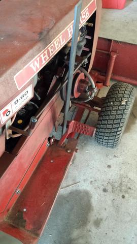

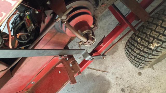

KyBlue 655 #1 Posted December 8, 2014 my Snow Plow has been missing the angle lever since I got it ...NOT COOL! I'm not about to pony up the cash for a new one from Toro, and Honestly Geno just wants far too much for the NOS one he has So I made my own ... Nothing Spectacular but thought I'd share so others can duplicate... Simple stock steel from TSC a Vice and my Jewlers Torch. Oh and a Hammer and Adjustable Wrench (to aid in bending and squaring) Still have the squeeze lever to weld up and mount then she'll be all ready for paint. 11 Share this post Link to post Share on other sites

daveoman1966 3,884 #3 Posted December 8, 2014 (edited) I've done the same using 1.25" wide flat stock...work great.. For the rubber hand grip, take the similar round hand grip from the implement lift handle. Just flatten it in your hand and push it onto the flat bar handle. You MAY want to knock off the sharp edges of the flat bar though. Edited December 8, 2014 by daveoman1966 1 Share this post Link to post Share on other sites

bmsgaffer 2,071 #5 Posted December 8, 2014 Nicely done! The TSC i visit doesnt have a good selection (middle of a city, so i think its pretty slow). I tried to do that with aluminum... didnt go thick enough, just folds over. I will be getting some steel and building one soon! 1 Share this post Link to post Share on other sites
KyBlue 655 #6 Posted December 8, 2014 Nicely done! The TSC i visit doesnt have a good selection (middle of a city, so i think its pretty slow). I tried to do that with aluminum... didnt go thick enough, just folds over. I will be getting some steel and building one soon! was just a matter of drilling a few holes and getting it cherry red hot and then it'll bend like butter. Looks great Blue. Is my mind messing with me again? Didn't you furnish a bunch of great smoked eats at Geno's meet and greet? Geno, how could you!!??? that was something taken care of between geno and I... Lol I had asked about the lever months ago. I'd rather make one to be honest. Just hate using Nos parts... 1 Share this post Link to post Share on other sites
bmsgaffer 2,071 #7 Posted December 8, 2014 Aha. Dont have a torch. I do have a welder though so I may just cut it into sections and reweld it. Or may look into making a finger brake from a harbor freight press... dont really have room for that either though... Someday! Share this post Link to post Share on other sites
KyBlue 655 #8 Posted December 8, 2014 Get the Metal and come down... I'll do it for you... No problem. 2 Share this post Link to post Share on other sites

KyBlue 655 #19 Posted December 10, 2014 Nice job on the lever a little paint and better than new!! Exactly ... Thinking I'll let Geno use some of his Rattle Can Skills to get it up to my Standards ... Will get the handle fabbed tomorrow night. Sadly my Welder was damaged when it was on loan to somebody and is out of commission till they give me the money for a new torch (they cut through 90% of the wiring) So I'll have to go old school and braze it together... 1 Share this post Link to post Share on other sites
